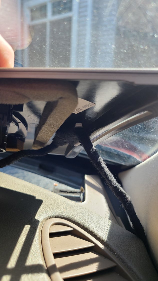

I was able to remove the Defroster Vent Panel (Demister Grille) form the 2006 S Type donor car without damage. The only issue that I have now is that I cannot seem to get the plug out of the harness for the sensor. I saw a video that made it look pretty easy but I can't get it out for the life of me and I don't want to break it anymore than I already have by trying to pull it out forcefully. It would be a shame to get that 18 year old panel out without damaging it and then crack it by removing the sensor plug. Any help would be appreciated, so far it still works in the 2006 car so I advent created any new problems in the circuitry of the donor car.
One other issue is that the wiring seems to have a special clip on the far end, passenger side, that I want to be sure of how to manage, again without damage to the panel. I have included photos of both areas to highlight my problems.
Once I am done with this, I will post all of the issues that I encountered, there were a number that I did not expect. The above two being a couple of them. Thanks in advance and I am sorry for the dark photo of the passenger side clip. It was the best that I could do.
Plug to sensor. It had some wings on the plug that I was pushing on that broke. The receptacle remains undamaged.
Passenger side clip

Retaining clip on passenger end of the Defroster Panel
Side view of clip
Top view of clip and wire.
Passenger side retainer clip inserts into this slot on the undersurface of the Defroster Panel
