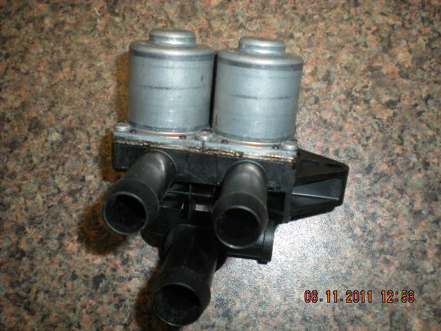

Searanch; If you read through the entire website at www.jaguarclimatecontrol.com you'll find that the repair price for the RCCM (remote climate control module-under dash above glovebox on 03-08 S type) is now $345.00 and a replacement DCCV (dual coolant control valve - front passenger side of engine behind radiator -bitch to remove) is $150. I assume this is all plus shipping.
The Bosch valve I bought, advertised as new on Amazon furnished through an aftermarket seller, actually came in as a used valve. I'm going to try it after checking the resistance, but Amazon gave me a $20 refund,
so I have to say they're trying to be fair and I can still return it for a full refund if it doesnt work.
