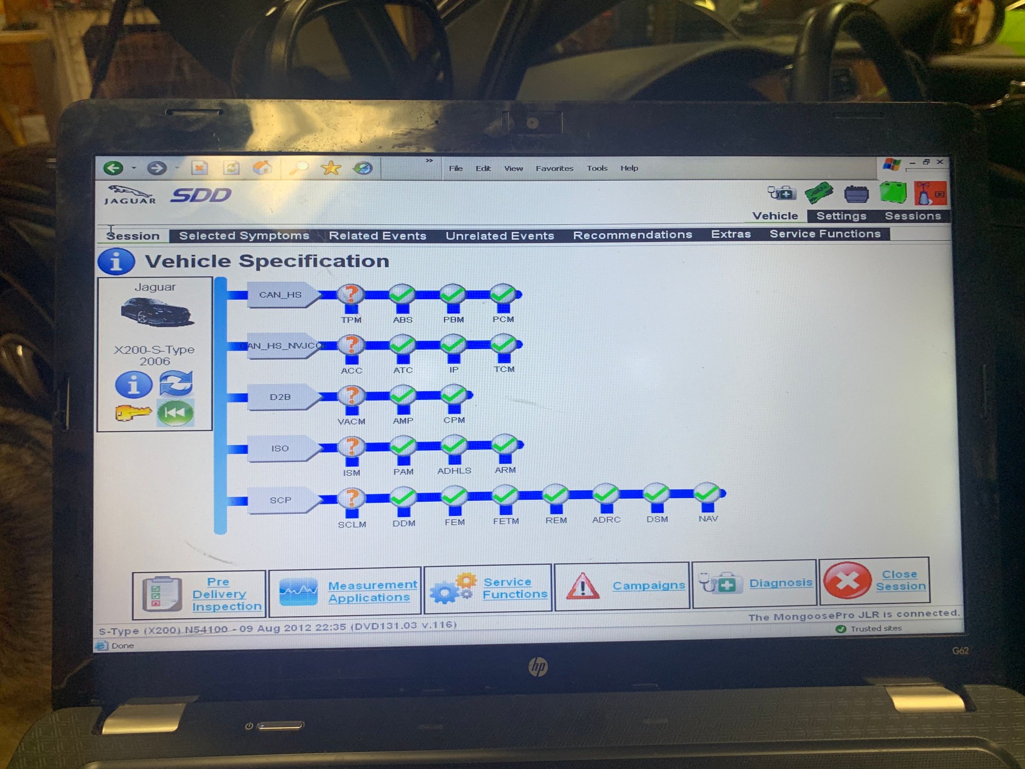

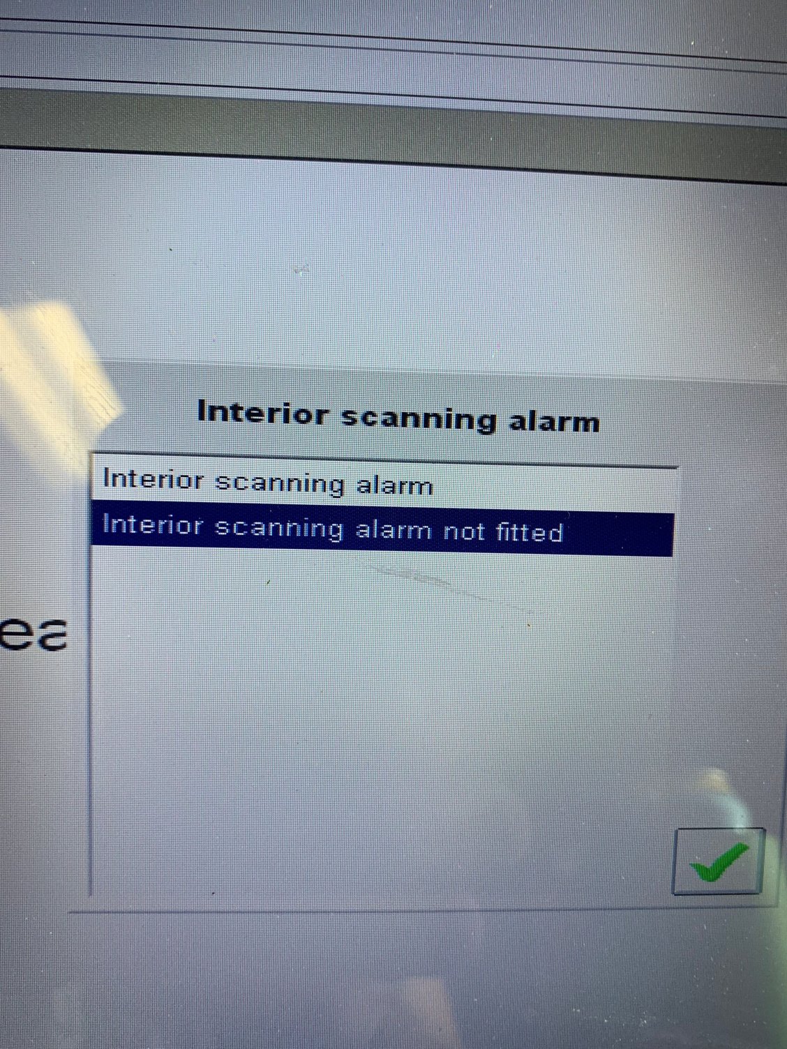

Playing w SDD v131.03 on my ‘06 STR and it asks me if im fitted witha canister close valve. Am I!
how do I know? Also, I had bluetoothe voice activated phone and controls but do I have these:
intrusion sensors
multizone voice activated or just voice activated?
hansdfree cellular phone?
help me find the missing modules

I have an 06 str and it is yes to the close valve ..the others will be identified on the module screen right after data collection is done ,..depends on the options of your car.. the question mark modules are not fitted.....a green check mark means module fitted....it looks like you have no intrusion or voice control module ....ys to handsfree cell phone.....if a green module has !, Then it has a code stored

Turns out a bunch of modules were not communicating and acting like they werent there. But I dug around and saw the voice control module on a big bracket behind the amp. The amp was reset too. So was the handsfree Bluetooth. Not sure about the intrusion sensors either. The overhead console has the cur out grills for one. But I dont know if its in there
