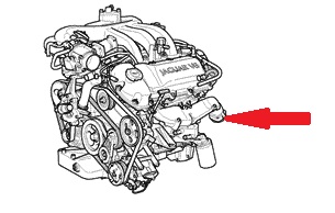

A pic often helps. Here's the complete engine unit with one of the the Exhaust Manifolds arrowed in red:

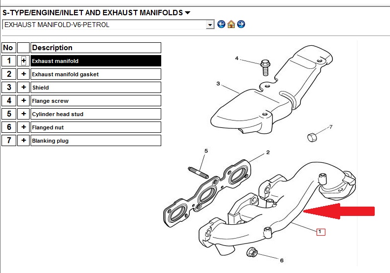

This illustration from the Parts Manual (see item 1 arrowed in red) makes it easier to identify exactly what you're looking for:
The Exhaust Manifolds are covered by Shield (item 3)
