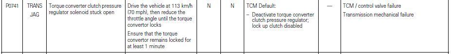

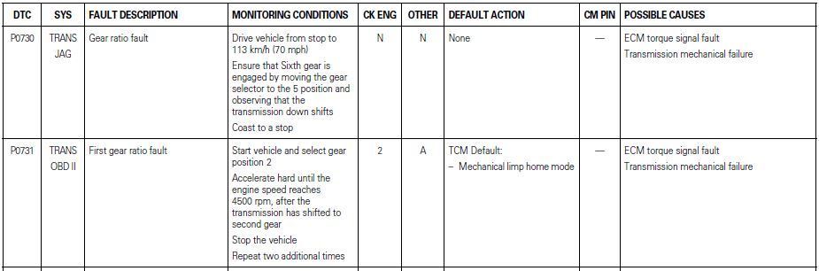

Here are the definitions and published possible causes of the Diagnostic Trouble Codes you have listed:
When I see so many different DTCs that could be related to communication with the Mechatronic/Transmission Control Module, my first suspect is fluid contamination of the transmission electrical connector. This occurs because the rubber O-rings on the connector sleeve harden and contract with age, allowing transmission fluid to leak into the connector and to insulate the connector pins, causing a loss of communication with one or more components inside the transmission.
The connector is high on the rear end of the transmission and can be a little difficult to access. There is a locking ring or collar with two tabs that must be rotated counter-clockwise until it releases from the connector sleeve. The harness connector can then be withdrawn from the connector sleeve. With a bright light and an inspection mirror, check for evidence of fluid in the connector. If you find any fluid, the sleeve must be replaced. To replace the sleeve, the pan must be removed again for access to the sleeve locking handle.
Regarding the valve body seals, they tend to harden and compress, causing a loss of pressure between the transmission and valve body, so just because the seals are intact does not mean they are still sealing properly. It would be prudent to replace them when you are changing the connector sleeve.

All of the DTCs you have could be caused by electrical issues. The first three codes in the definitions below indicate a problem with the ECM torque signal. This signal originates with the Mass Air Flow Sensor, but is communicated to the Mechatronic/TCM by way of the ECM. So another reason to check the ECM electrical connector for water ingress.
The P0741 could be due to a problem with the electrical circuit to the TC clutch pressure regulator solenoid. If the solenoid is not being electrically controlled properly, it cannot regulate the hydraulic pressure to the torque converter clutch.
The definition of P0720 is Output speed sensor circuit failure, which suggests an electrical problem.
Mechanical problems are not unheard of, but electrical problems are more common.
