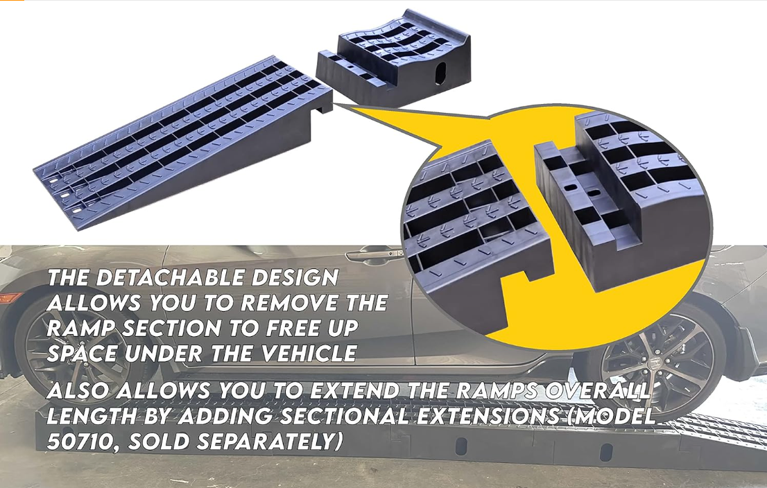

Bump to an older thread. I just picked up a set of detachable car ramps from MaxxHaul, item #50709:
https://www.maxxhaul.com/copy-of-50699
I purchased these to make oil changes easier on my car. With regular 1-piece ramps, the sloped portion gets in your way as you try to reach the oil filter. Jack stands are a little better, but still block easy access. You simply drive up on the ramps, and then remove the detachable inclined portion. Voila!
Eastwood offers their own version (#23048), which appears to be identical:
https://www.eastwood.com/eastwood-de...-ramp-set.html
This pic, from Eastwood, shows how the inclined portion separated but not yet moved completely out of the way:
Edit: I forgot to mention one little tidbit. Make sure the surface below is flat, or slightly raised in the middle. When I first tried these new ramps, I positioned them on a spot with a little dip (watch it!) in the middle. Under the weight of the car, the leverage wedged the joint together slightly and made it difficult to separate the pieces. I backed down, moved to a flatter spot, and all was good.
