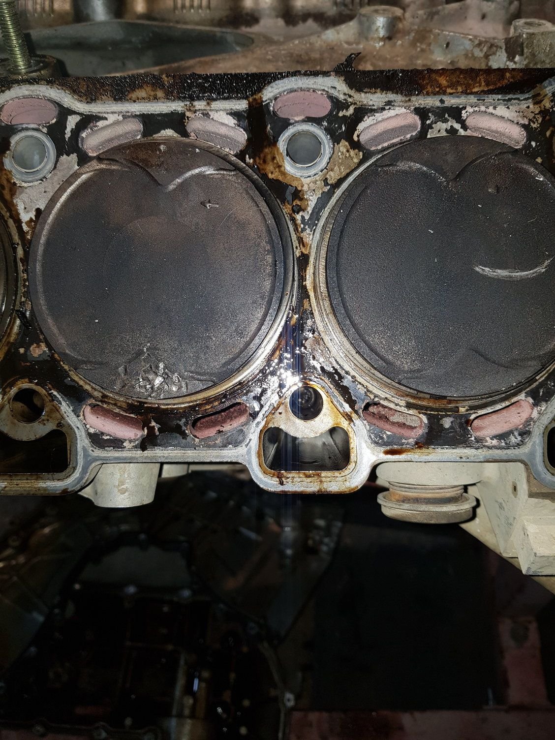

Finally finished engine rebuild
At last have engine running perfectly
complete rebuild not cheap 11 k nzd
Had a few fault codes come up which were doing my head in which ended up being caused by 3 faulty ignition coils
from new had replaced all 8
Had 8 more sent to me now no fault codes at all
