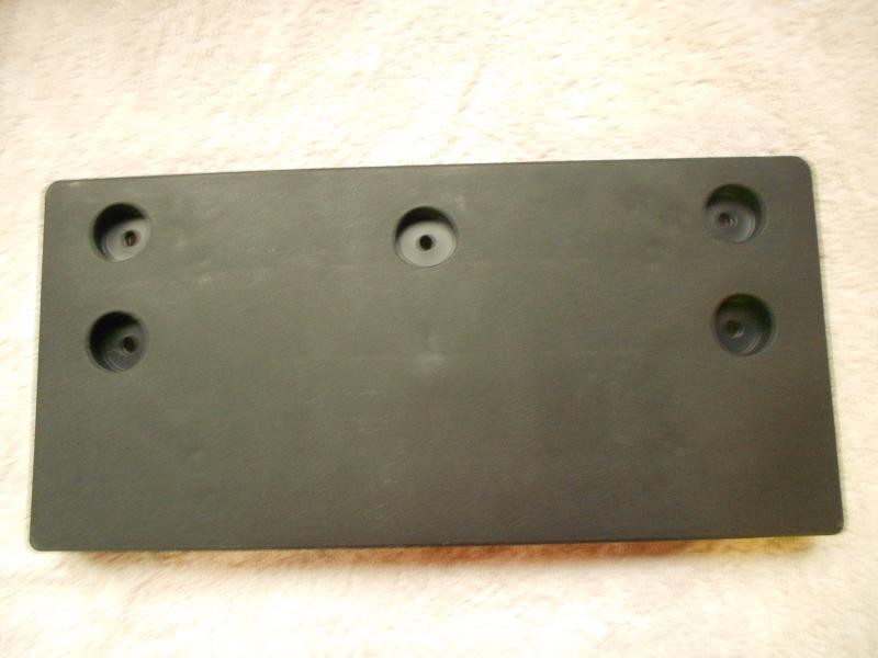

Mikey, these pictures are from Joyces Jag. Since it has been a southern vehicle all its life no front plate needed. It has been sitting in the trunk since the vehicle was new. Its a 2005 but you'll get the idea.
At first I thought maybe 3M double sided automotive tape to secure the bracket to the front bumper, I don't think so now. It looks like the only and safest way to attatch is with screws unfortunately.

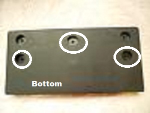

The way the front license bracket is mounted is with rivets.
The Jag part number for the rivets is: XR813185 - you need 3 and they go through the bumper cover.
In using Rick's picture - I marked the rivet locations and marked "bottom" as well.
Regular 3/8" rivets won't work - they aren't long enough and forget screws - they won't hold unless you drop the entire front bumper cover and secure the bracket with a nut/bolt.
