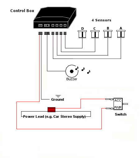

After some more research:
This Jaguar kit was oviously designed as a retrofit probably at dealer level, prior to the latter year models which depending on markets, came with both front and rear factory fitted with just the one module controling both ends and with the included overhead/roof console "P" button being able to switch the front ones off.
So this would benefit cars with the rear aid Jaguar module (which you can retrofit as well) but of course be seperate in operation, with the "P" switch to be mounted nest to the gear selector after drilling a hole.
This kit does not have any Jaguar bits from what I can gather and has no parts interchangeable with the factory fitted front/rear combined system, that is looms are different, sensors are different etc. It is essentially a high quality aftermarket kit with a 'Cobra' module and a 'Ford' stamped female connecter where the centre console 'P' switch connects to. Also it is the same an X Type kit that was offered for that model (except the X Type kit is missing the 'link lead' but could be easily adapted to fit).
So question is why would you bother buying these kits (at least $400US) when you could source a quality aftermarket one for around 60 pounds. Photos attached.
You would need to compromise on a 'non genuine' switch on the aftermarket kits.
I have not been able to work out what this genuine Jaguar kit P rocker switch looks like but I do assume it would be a Ford part.
