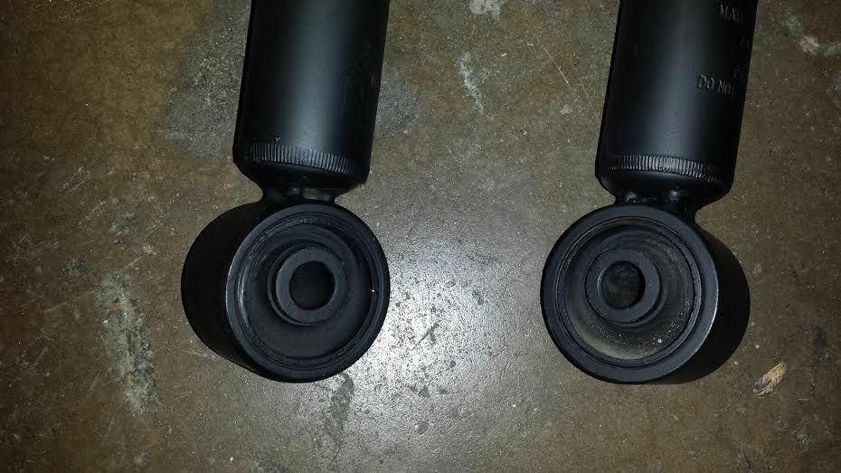

My right strut is making clicking noises.
After checking found the lower bushing (strut to lower control arm) is completely gone, metal to metal no more rubber.
The strut itself is good.
Does anybody know the size or reference for the bushing? ( I understand that the bushing is part of the shock and does not come as a replacement part)
but anyway, if I can get the right width and length I can get one and replace it.
(Adaptive Damping Control BTW)
picture for reference only, not my actual struts
