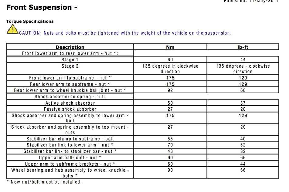

Thanks for the tip. I will do just that as I know all about sway bar tension. I've worked on a few before. What I wonder is how to properly tighten the nuts on the upper A-arm and the swaybar balljoints. Takeoff and reinstall with an impact wrench but, how tight to set the wrench?

Here's the torque settings:
Torx-bit size for removing XKR lower strut bolt?-screen-shot-2014-05-02-10.54.11.jpg
Note that they say to use new nuts/bolts in many cases
Attachment 82484
Yes, I ordered a set of new nuts and bolts per the factory service manual. I still got to purchase a T60 torx bit.
