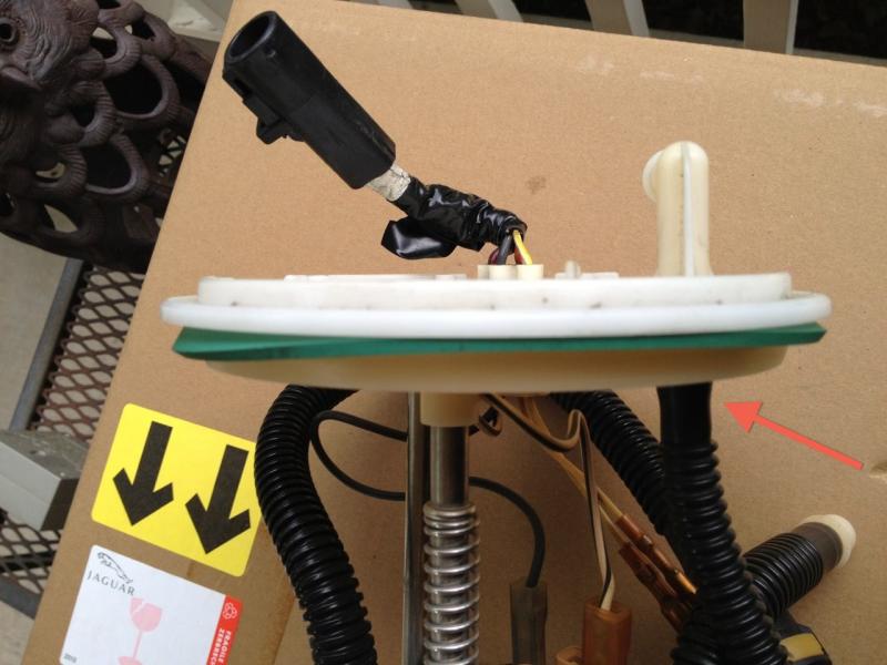

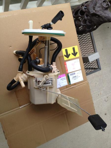

Here are some pictures.
The first is for the whole left side pump.
The second is a closeup of the top of the pump and shows the hose that came of twice pointed to by an arrow. It is the connected to the output of the pump.
The third picture is a closeup of the hose attached to that connector (tank side), where it was coming apart.
This is how I got it from the dealer. They reattached the hose again before the new pump came it to make sure this was still the problem. Still not sure what was causing it to come off. I can not easily remove it by hand right now.
