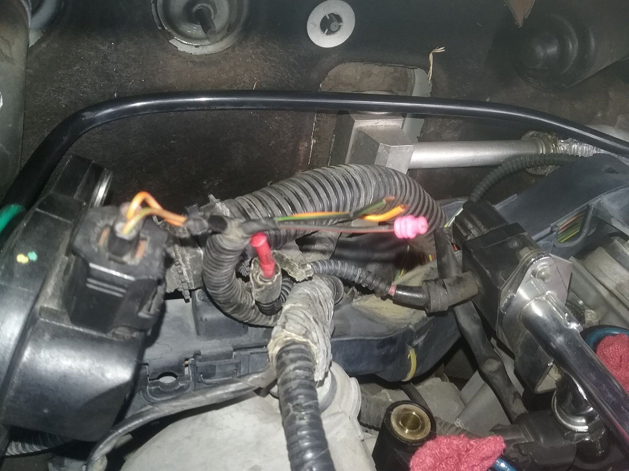

Folks, I am in process of doing the intake gaskets on the car. In the process of removing the upper intake (plenum) I either inadvertently pulled these wires out of the harness or they were already loose (not sure, but it was probably me). The harness goes to a plug just above the fuel pressure boot fitting as you might see in the pics. I think I can re-attach the wires either by ..a. buying a new harness and spicing in the wires or b. somehow reattaching the loose wires to the harness via solder or a round connector that will fit is each harness hole. BUT I am unsure as to the wire color sequence going into the harness. One of the wires (brown/red) retained a small pink rubber bushing and from that I ascertain it goes far left as viewed from the back of the harness, since the two harness holes on the right have the pink sleeves still in them. But I am not sure if the yellow wire goes in center and the green/brown goes on the far right outside or vice versa. Can anyone advise me or possibly respond with pics of that harness on your car? appreciate thoughts.

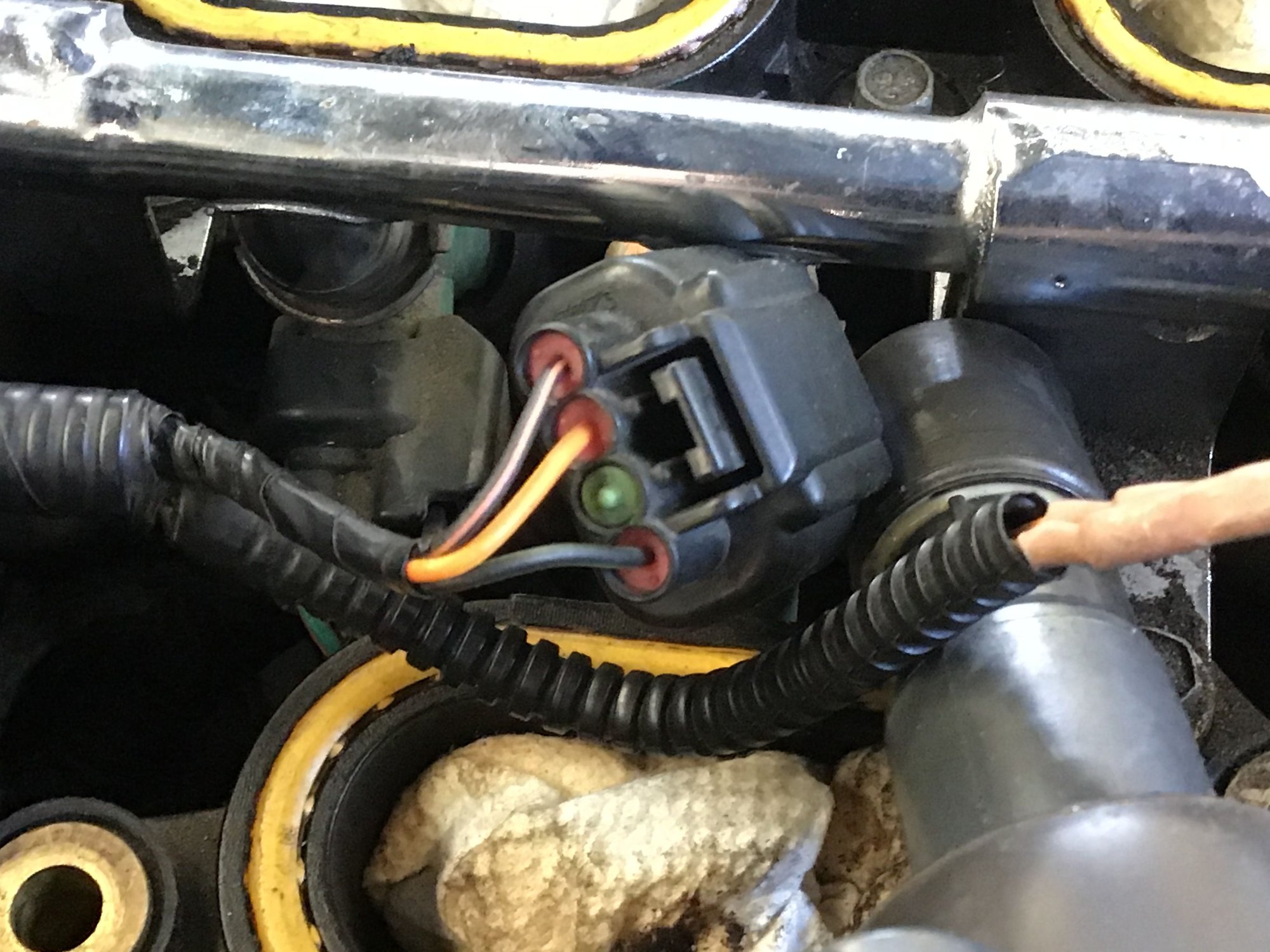

Here's a pic from Rick (Joycesjag) looks like the Orange/Yellow one goes in the middle.

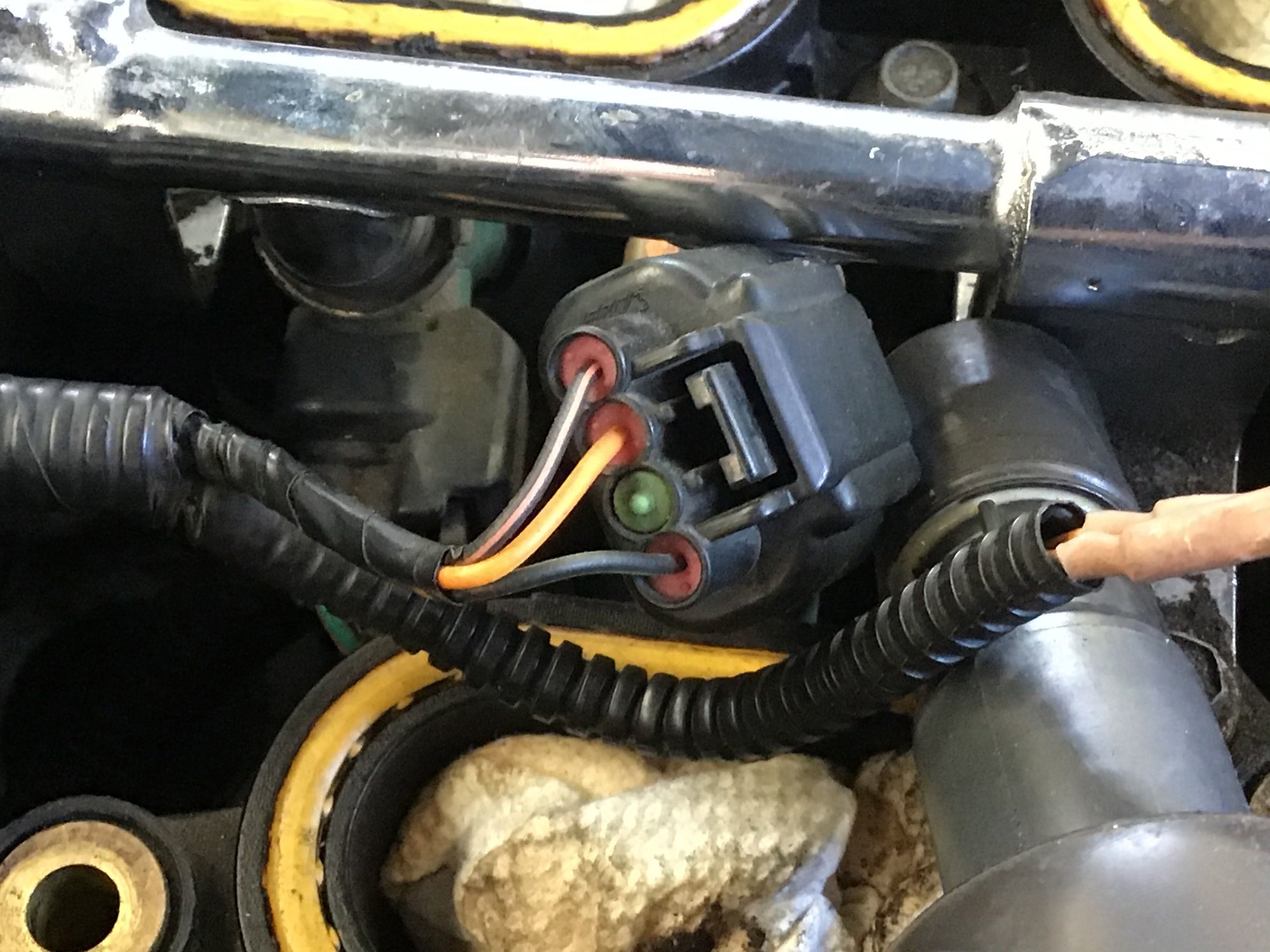

Default Pic of my MAP Sensor plug
Hope this helps.

Thank you, your photo saved my life. Today I took off the intake and snapped all three wires off. I depinned the pins and soldered all three and used your photo as a wiring reference.
