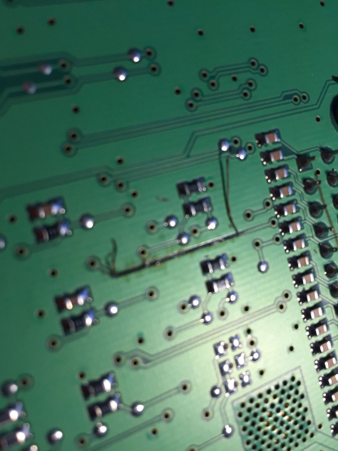

well, there is a problem it looks like.
But how do I repair that, I have repaired boards in an earlier life, 65 years ago but they were no where near that fine

this is the part i was asking if i could replace with one from a later year, say 2005/6
But how do I repair that?...
You don't. Save yourself some major grief and send it off to be repaired AND upgraded so it doesn't happen again:
https://jaguarclimatecontrol.com/repair-and-upgrade/
Resist the temptation to bridge the damage with a jumper wire:
https://jaguarclimatecontrol.com/new...t-to-see-this/
You have encountered a VERY common problem on 2003+ cars. This is not uncharted territory. The problem is so common, a guy set up a small business to repair and upgrade these modules. As stubborn as I can be, if I were in the same situation, it's still time to pay da man and have it done right.
