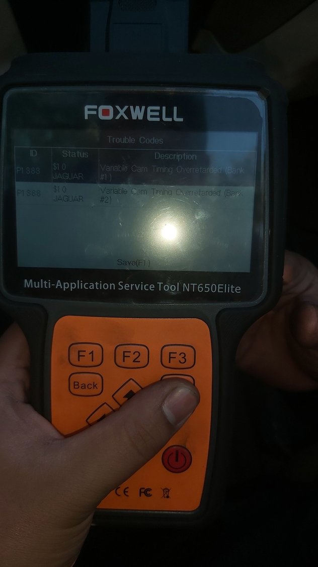

Originally Posted by Ralph Majarais
but now engine light is on...
Are you talking about the little check engine light on the dash? If that is illuminated, some corresponding fault codes will be stored.
Please have the codes read with a scanner or code reader, and post them here. Please post the 5 digit code(s) such as P0301, not the definition the reader may display. Some codes are Jaguar-specific and the generic definitions are are not always accurate.
I am surprised three different mechanics are giving you three wildly different ideas. Sounds like none of them even bothered reading the codes, or are ignoring them and suggesting unneeded expensive repairs.

Your picture is hard to read, but does that say P1388? If so, that’s a fairly common fault, often with P1383 for the other bank. No need to panic, it often clears up with a fresh oil change.
Everything you ever wanted to know here:
https://www.jaguarforums.com/forum/s...errors-234131/
https://www.jaguarforums.com/forum/s...bad-vvt-68687/
Old Sep 23, 2020 | 09:19 AM
well im happy now, thank you very much
