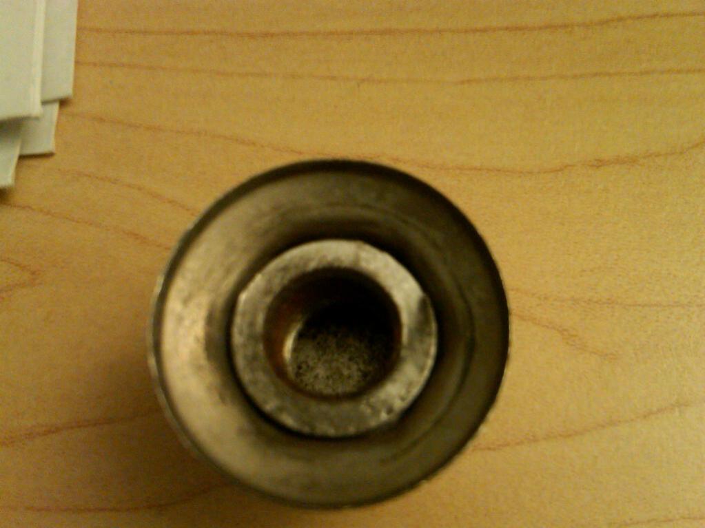

Look at the picture and tell me that this lugnut would have failed the way it did if it was solid in it's construction instead of just having that thin inner sleeve.
And lets forget rust as a factor because even though the outside of this lugnut would still polish up brilliantly cause it's stainless... The inside is still all rusty. Rust is aesthetic on the outside, it's the mating surfaces that count.
George

Ok for some reason that picture didn't take.
See the outline of what appears to be a "ring" on the inside of that stainless cap? That's the diameter of what's left on the lug stud. Basically they thin down the part that takes the cap, and just press (not even weld) the stainless cap on to make the lugnut pretty from the outside.
Let's try this again.
George
