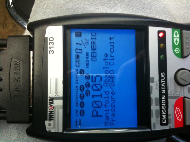

I did a lot of digging up on this PO105 for the S type, and only found one thread to have any info on it. Can someone please share some insight on how to replace the MAP sensor on my 03' STR with 94k miles on it. My check engine light came on and hooked it up to the scanner and got the code. I hear its a pain in the **** to replace. Would this be a DIY job or am I better off taking it to the indy jag shop and have em do it. Any info on the procedure would be grately appreciated with some concocted beer
Ohh one more thing I'm assuming i ruptured the diaphragm in the MAP, b/c when I floored it a few days ago I heard a loud pop sound like a backfire then my check engine light came on; went home and reseted it and now today it popped right back on, so most likely cleaning it won't help i'll need to replace.
