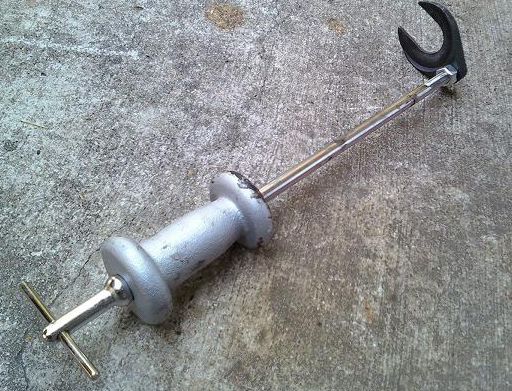

I usually can pop out the axles with two flat blade screw drivers but if not I do have a slide hammer attachment that works well.
