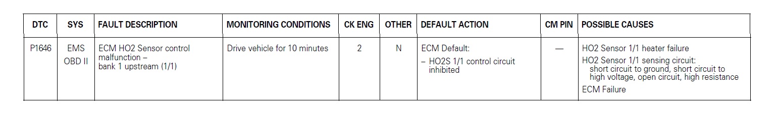

Basic scanners can give misleading results with Jaguars but generic code lookups can be even more dangerous! Here is the Jaguar extract for P1646:
If the vehicle runs, you can reasonably ignore ECM failure as a possible cause and concentrate on the HO2 Sensor.
