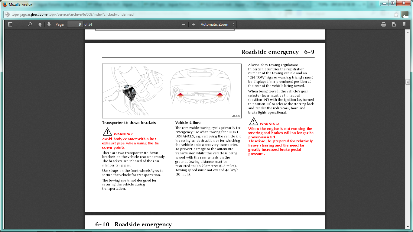

Years ago we used to disconnect the prop shaft when towing autos, not sure how much trouble this would be on the s.
Old Sep 12, 2013 | 08:43 AM
Posts: 121,143
Likes: 6,654
Anything has to be better than leaving it in Asda's car park!

Ayhow it's back here on a low loader so now the fun begins,I'll keep you all informed on progress,or lack of it!
