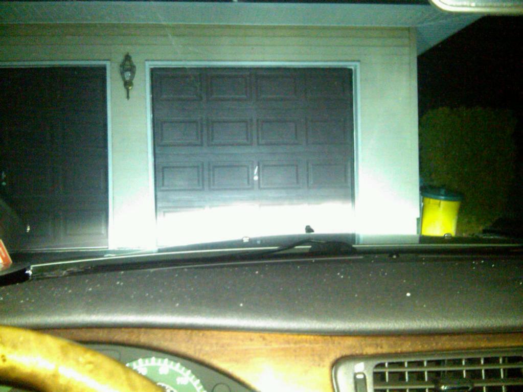

Ok so I got the kit in.
Everyone's fears were unfounded as far as not being able to do it without pulling the headlight and bumper. There is room. My ballasts are off to the sides of the headlight between the fender and the headlight housing.
I don't think I got the best quality HID's. When they are up against the garage door you can see a bit of flicker on the edge of the beam. But once again, you get what you pay for. I think I may just keep this kit as a spare (the duplicate H7 one) in case I need extra parts.
(I still haven't heard back from that ebay seller).
I think he may have set 8k instead of 6k because the light seems bluer on the road than I remember 6k being, but the light output is night and day It's like the old headlights were those 194 bulbs I pulled out.. Honestly fog lights especially HID ones on this car would be an exercise in futility and overkill. (Although I still want them
I just pulled the two little wedge bulbs out, and put the holders back in the headlamp, they were pointless...
Can you tell me off hand which adjuster will aim them down? I didn't touch the aim, but it didn't seem too bad. I took a crappy blackberry pic of the lights against the garage door (albeit the car is on a bit of an uphill angle due to my driveway).
). I just pulled the two little wedge bulbs out, and put the holders back in the headlamp, they were pointless...

I don't think i've seen a kit so far that has a modified per car specific back covers to support sealing the back of the headlights. Unless i've been missing out lol. But yes mines are open on the back as well, which i don't like either, that could suck in dust and dirt not to mention water from washing the from in between the fender/hood/headlight corner, because i saw a tad water siting there on top of the headlight when i opened my hood, and that was a day after washing my car but not driving or moving it.
Some sellers kits of 6K's are deeper, bluer then the others which might be more purplish, it all depends on the kit. The best thing is to stick to the same seller that supplies the same brand where the color temps will match at least for the fogs/headlight combo, and i didn't follow the rules myself this time lol. Getting the fog kit elsewhere from ebay vs. my headlight kit. Hoping for the best.
The two little wedge bulbs you're referring to, i took them off too and put them back with the metal legs ripped off one on each side, just to have them for decoration vs. an empty holders...
The adjusters for up and down are the ones located on the top of the headlight towards the fenders.. I adjusted my right side up it was shooting too low, and i tried to adjust my left side headlight towards left outwards, but my adjuster was just spinning without adjusting it, guess its busted so i left it alone since it's not that bad at all.
Hope this helps.
Hope this helps.
