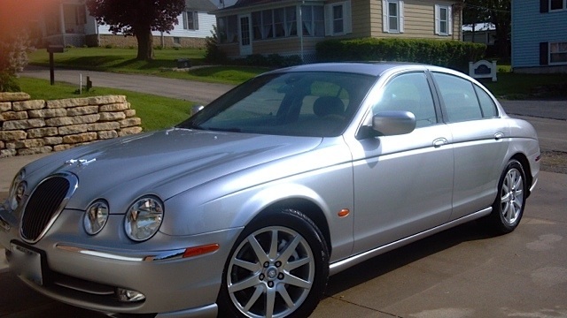

Again it's a beautiful car inside and out and it's been very dependable, I'll attach a photo.
