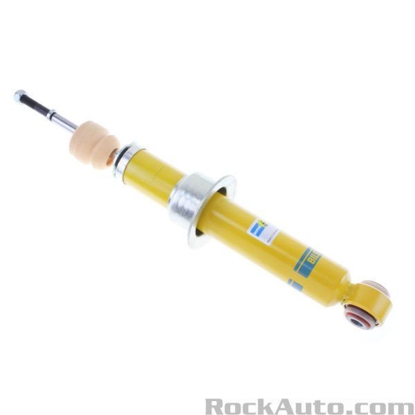

Old Nov 13, 2019 | 12:10 AM
dauraf's Avatar
Joined: May 2019
Posts: 19
Likes: 7
From: Reseda, CA
without CAT
without CAT
with CAT
Is it possible to replace CAT shocks set with the non-CAT set, all are the same size or different? Same coils? I can unplug the CAT controller but don't know if can reuse the coils and strut mounts (since they are in perfect shape) Cant see the difference from the online pictures, all looks similar
