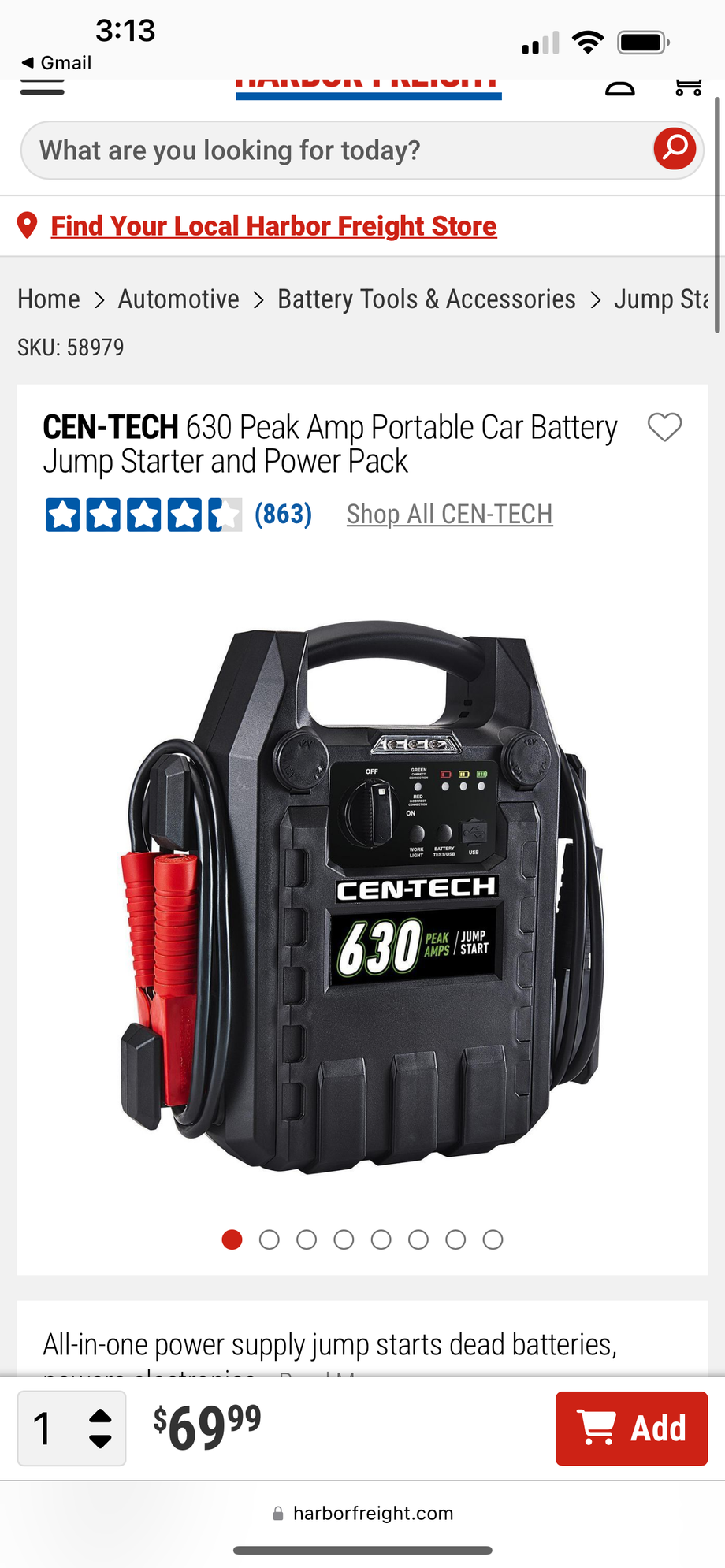

Is something like this qualified? I will borrow one from my mechanic tomorrow. I’m hoping this will help get my car started.

Can you at least give some car details? Include engine and miles on the car. We need to start at the beginning!
No you need a regulated DC power supply with low ripple! Not any kind of battery chargers/jumpers.
Here is Jaguar requirements for the power supply. Also NEVER use the laptop without it being plugged into AC power.
These two shortcuts are responsible for most of the bricking car problems.
As I have posted before SDD consumes massive power and I have measured 30+ amps with the car off!
