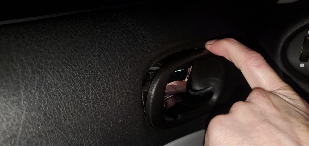

2003 model and the innder door handle bezel/insert is cracked on both front driver/passengers sides of the door. Is there an easy, common model (Ford?) replacement for these pieces? Or are like some Jap door handle parts does anyone make replica replacements?

Welcome to the forum Mike. Ebay has quite a few used and new starting around $35.00.

Jaguar parts are determined by the last 6 digits of your VIN. You need that to get the right parts. That part also comes in many colors depending on your interior.
I will assume yours is "Warm Charcoal" or black.
Looking at the JEPC/J-Part catalog there are several different part numbers again depending on your VIN.
Possible part numbers are; Note these are listed for VIN's above M45255. This is the common number you see for what's called the "Face Lifted" S-Type. Which your 2003 is but again do check your VIN!
Drivers side-XR825068LEG. Note the LEG determines what color the part is.
Passenger side-XR825067LEG.
But they are expensive at $40-$50 each!!
I do see used ones on EBay for about half that but be aware those are plastic parts which are now over 20 years of age. They are just all brittle at this time. So a used one might not last very long.
