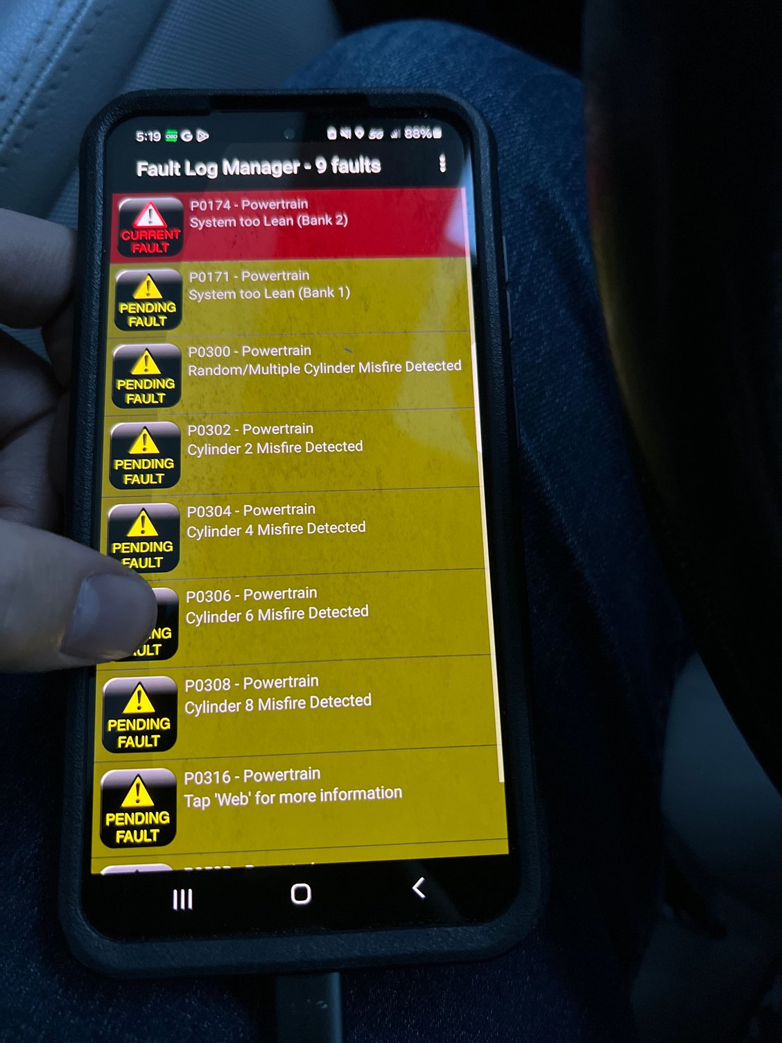

Was getting this same code as well, disconnected and reconnected the maf, reset the codes and now even though the car is actually running good and idling well, I’ve gotten these sets of codes… doesn’t feel to be misfiring but I’m not sure as to my next steps.
already have cleaned the maf with the proper cleaner for it, so I’m sort of stumped. Where could I get a replacement MAF that’ll work for the 06 STR? I know oem is the way to go but unsure of the best place to order one.

If your scanner reads the obd2 monitors check the misfire one for count data. It helps a lot even when you feel the car is running fine. I have a long post coming about my 3 year trans issues that are now resolved because of being able to see that monitor data cycles

Cleaning the MAF does not always work. The Denso part number should be molded into the top of the part itself. OE Denso parts should be available from a number of on-line sources. Parts Geek, FCP Euro, etc.
Why are you even looking at the MAF?
You have ONE bank problems so it can't really be anything that's common to BOTH.
Chances are you have an air leak. Best move to a separate thread BTW.
