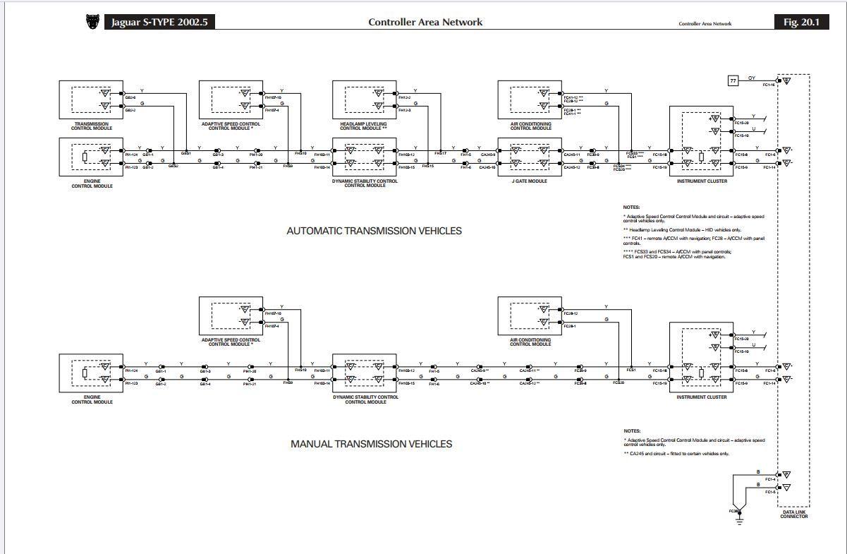

Hi
All the modules are linked via can bus, if you lose the loop any where the modules wont talk together and you get lots of problems
and most of the time wont start, for example unplug the abs module and the car wont start, link out the 4 connection on the connector for canbus and it will start ( linking out the connector just bypassing the wiring on the module you have just unplugged just continue the loop. cant be done on ecu. tcu and dash)
go on JagRepair.com - Jaguar Repair Information Resource and download the electrical manuals for your car free, at the end of the wiring diagrams are all the can bus loops, disconnect each module and check the wiring is ok
its very common for the wiring harness to get damaged behind the front wings and where it goes over the front bumper impact foam blocks and brackets, behind the front bumper.
a couple of hours of unplugging modules, check wiring continuity and bridging each module connector and you will find it.
