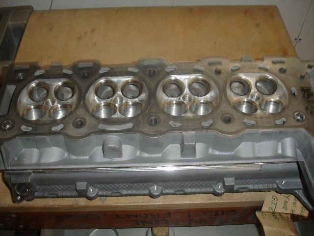

has anybody here gas flowed the heads on an STR and if so what was the performance gains please?
My ported heads. Cams are more important / bigger gain mods than heads.
Sorry to add to this older thread, but curious as to whom you had do the work. Looks rather beautiful!
