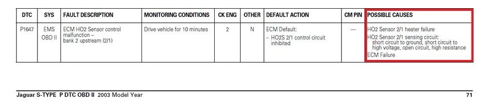

Here's the decode from the Jaguar DTC Diagnostic Guide. It's more specific in identifying which sensor:

The options are:
1. check HO2 sensor 2/1 and harness
OR
2. dance round the vehicle and sacrifice a chicken at midnight under a full moon
Diagnostic codes are an aid to targetted troubleshooting. It makes no sense to read the codes and then ignore the results.
