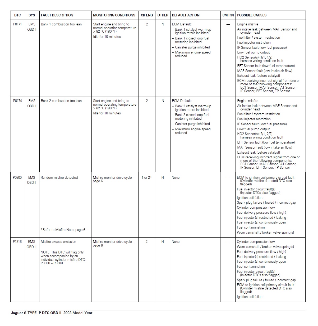

To help you check the shop is giving you the right information, here's an extract from the the Jaguar DTC (Diagnostic Trouble Code) listing for the ones you've found. Possible causes are given in the right hand column:
If they come up with anything not in 'possible causes' (and more expensive to fix!) post back here.
Code P1111 is a status and not a fault. It indicates all OnBoard monitoring tests have been completed since the last memory clear. You will always see P1111 or P1000 (OnBoard tests not completed since last memory clear.
