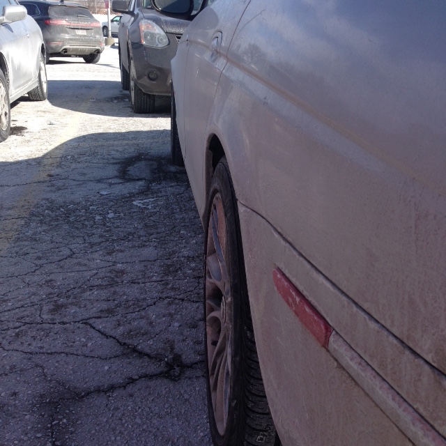

Challenge accepted! Must excuse Michigan road salt.
One picture shows near profile shot. Other show quarter side view. All four are identical 18" XF wheels with 245/45-18 Continentals.
I should add that the rolling diameter is smidgen larger than the original stock wheels/tires. However the speedometer is now spot on whereas the originals were about 4% over. So when my speedometer says 60mph, my speed is exactly 60mph. This verified by my GPS and highway mile markers.
