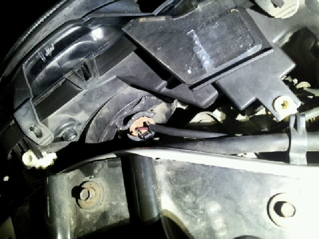

I put a rubber hose behind to hold light up. absorbs any movement. left side still works fine Paul
Ok, I'll take a look at my old one and check that out.
