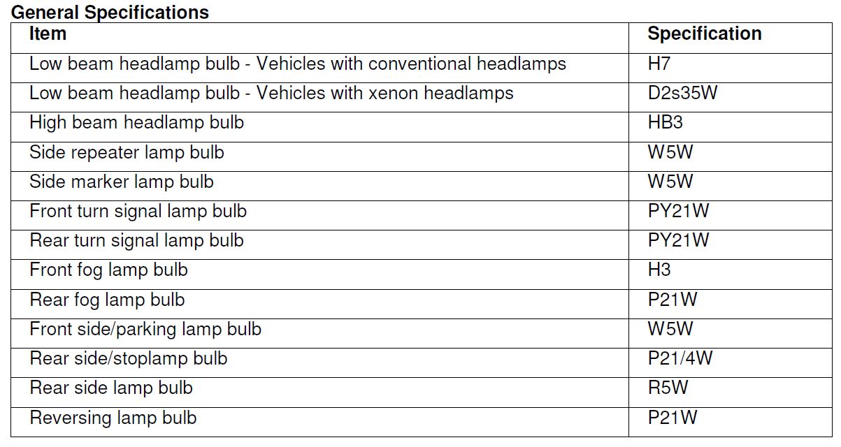

This will sound dumb but Jaguar uses some odd bulbs. I have found different number bulbs than what should be in there. On other cars I see more normal numbers like 1157, 1156.
The bulb numbers are listed in the owners manual.
Here is a chart from the JTIS.
