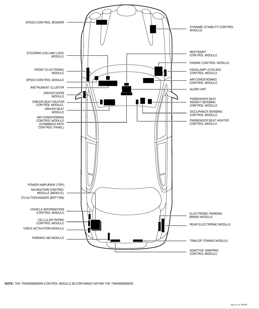

Third I don't know if you will be able to view this picture but the REM is located in the rear passenger side of the trunk.

so, what do i need to do to the REM to fix my problem? i tested the diodes with my multi-meter and they tested properly (in one direction).
