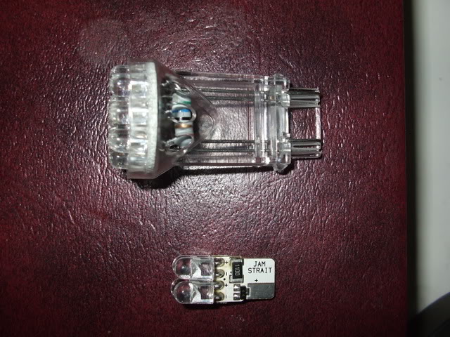

Where did you get your LEDS from? I actually measured the dome light and it came out to exactly 4 cm. Per Osrma Sylvania’s website it has the dome light listed as part # 6411. It also has the parking light with part # 2825 and I was able to use 194 LEDS, that I picked up at Kragens. I also used a different LEDS in my headlights turn signals, than what Osram Sylvania’s website had listed.
Have you checked out this website?They have some of the best and brightest LEDS. http://www.oznium.com/led-dome
These are my Kragens LEDS. What do you think? I eventually would like to convert to all LEDs lighting.
Pic of LEDs from Kragen
