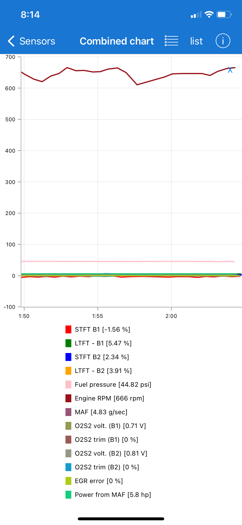

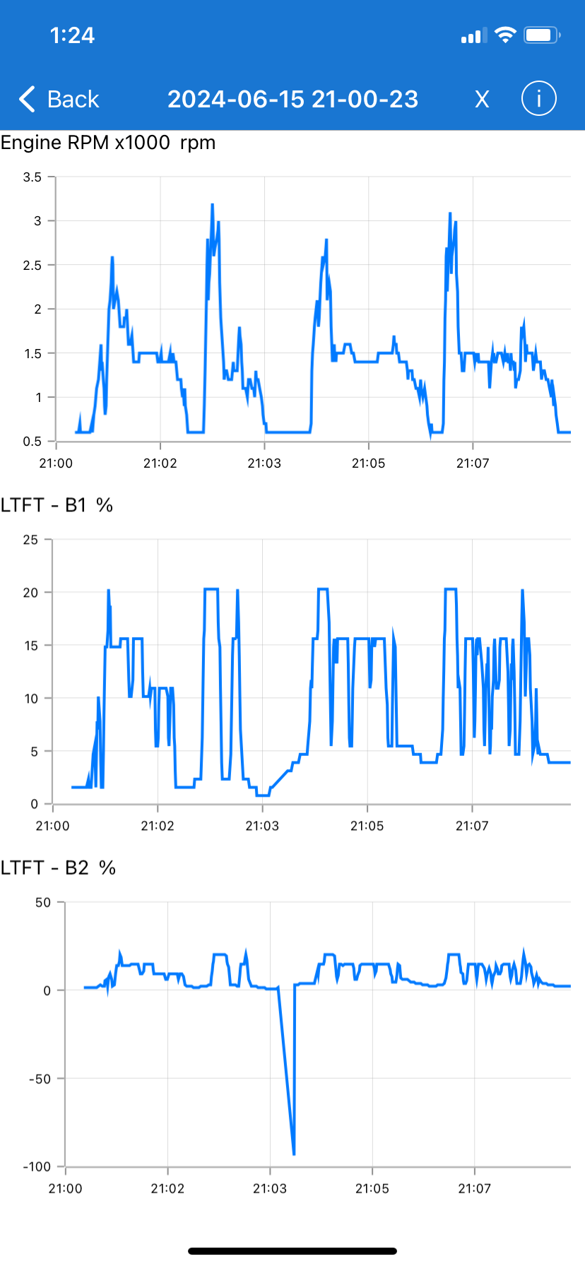

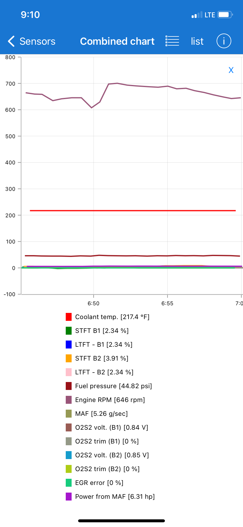

LTFT for Bank 1 and Bank 2 are ranging from -3 -> 20%. Measured while idling and then nearing 3000 rpm.
Does this indicate a vacuum leak ? Thank you.

History:
Day1: No CEL. Sometimes Stalling when starting. Action> Replaced Battery.
Day7: Code Appears (PO171/0174): Codes come & go Action> Firestone checked and said the breather pipe to PCV is leaking.
Car started stalling while crawling during heavy traffic, stop&go drive thru ...driving. Engine turned off and had to be restarted
Day20: Code Appears (PO193, PO171/0174): Action> Took to another shop. Diagnostic of PO171/4 said to replace the PCV valve. Replaced Valve and PO171/4 codes disappeared. P0193 Remained.
Day 30: Replaced the Fuel Rail Pressure Sensor. Stalling Gone !!
Day40: P0101 shows up with P0171/4. Car drives fine, no stalling. 18 mpg.

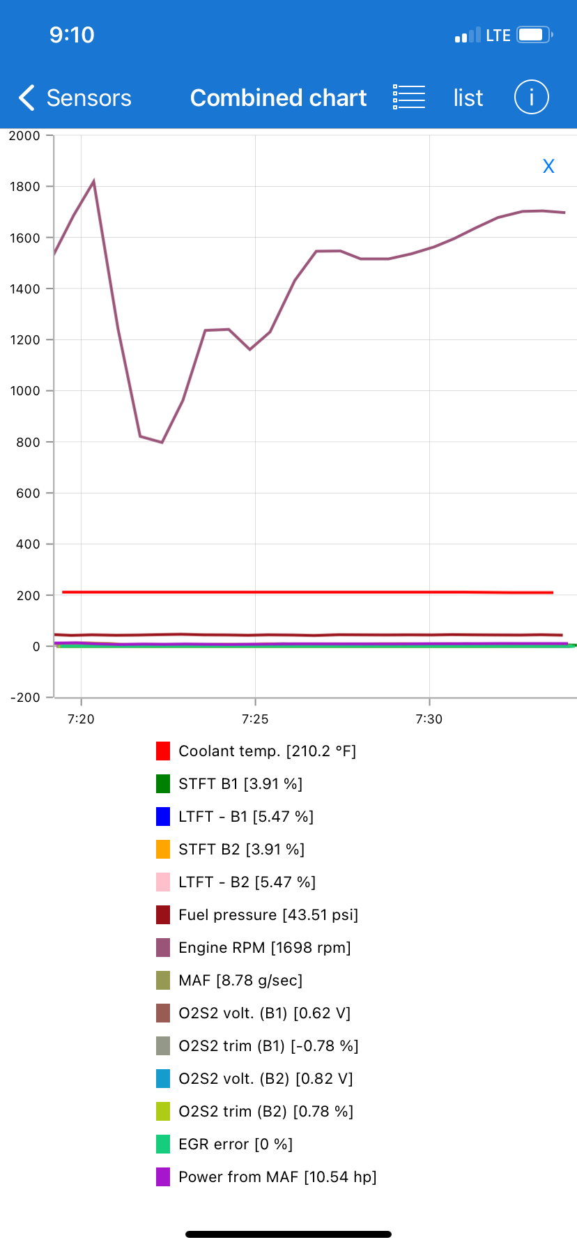

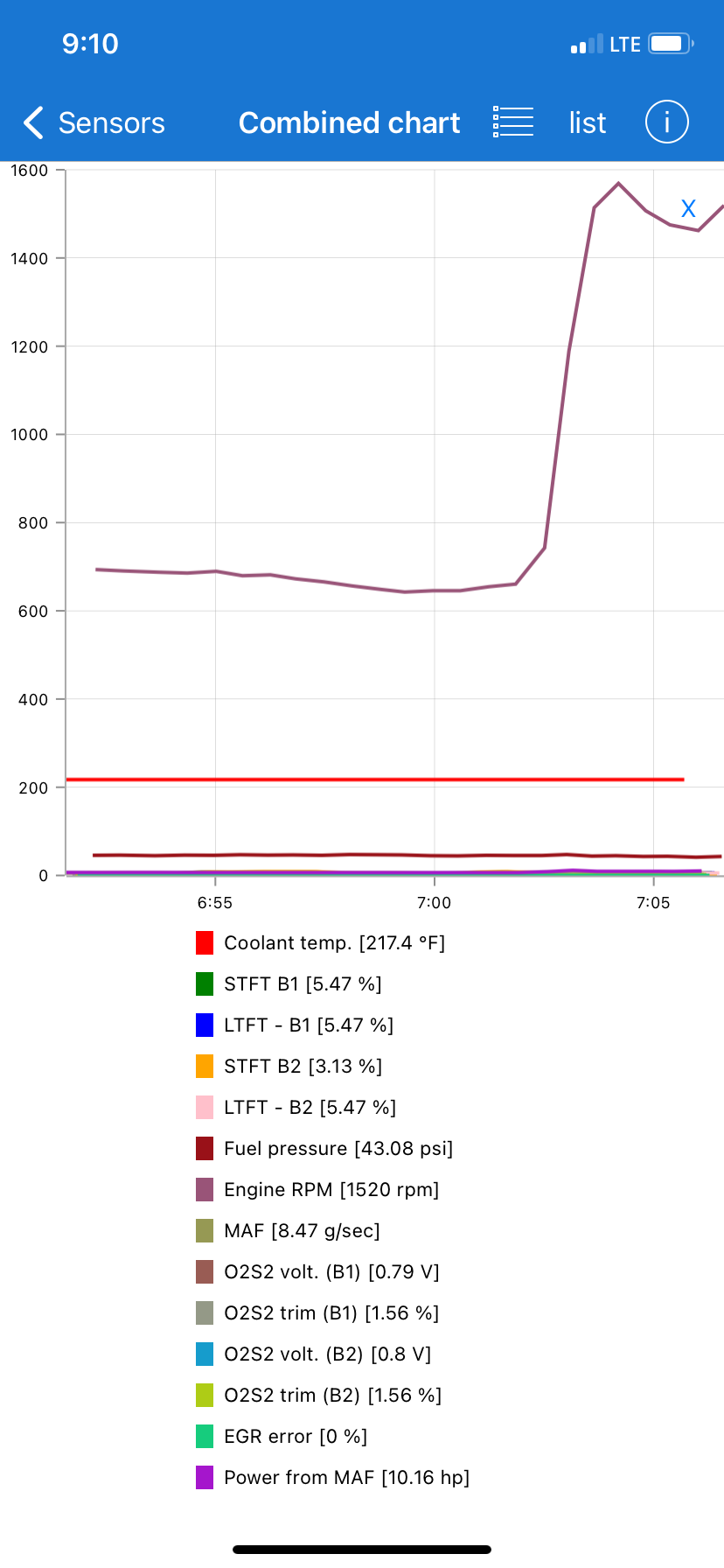

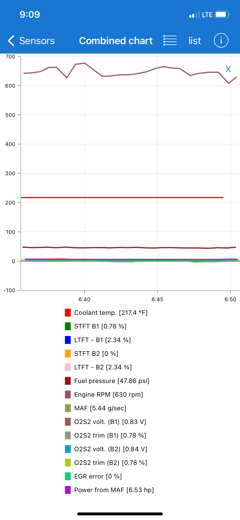

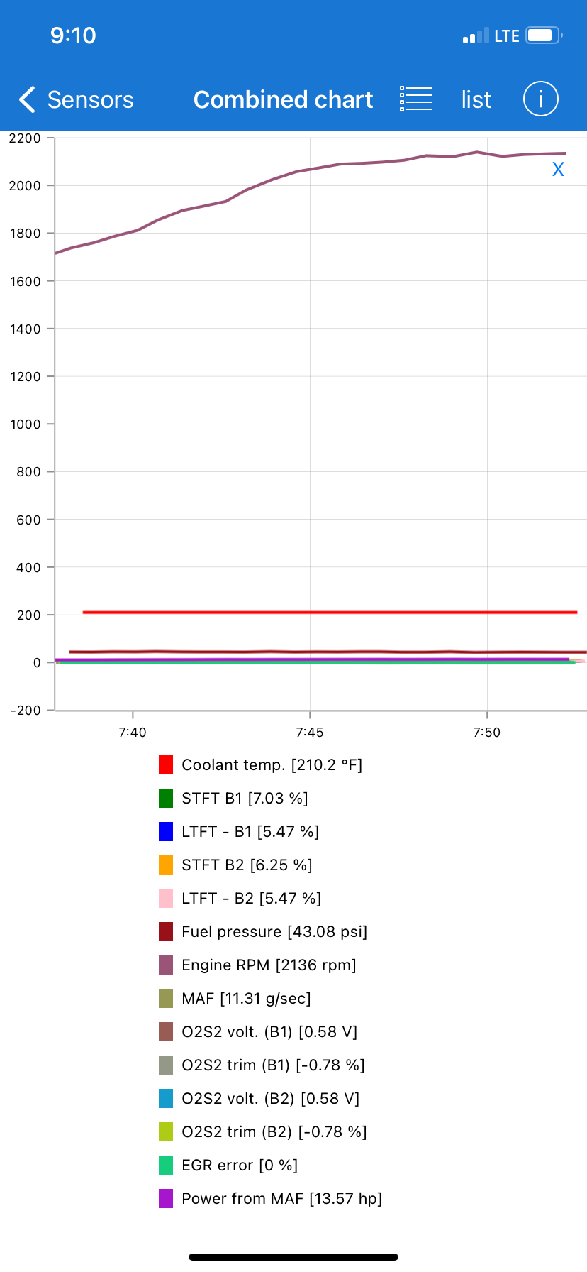

I have attached the Idle Readings and then during driving.

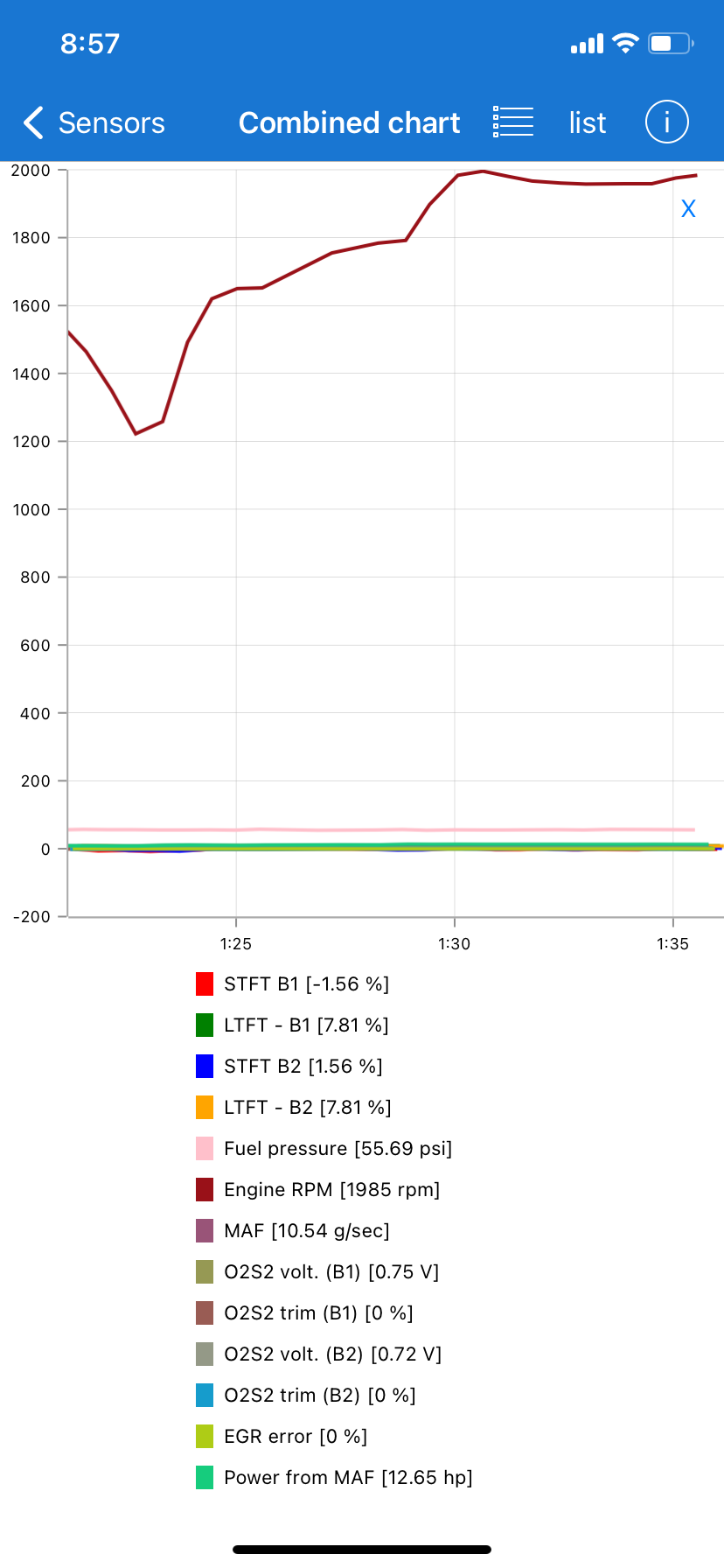

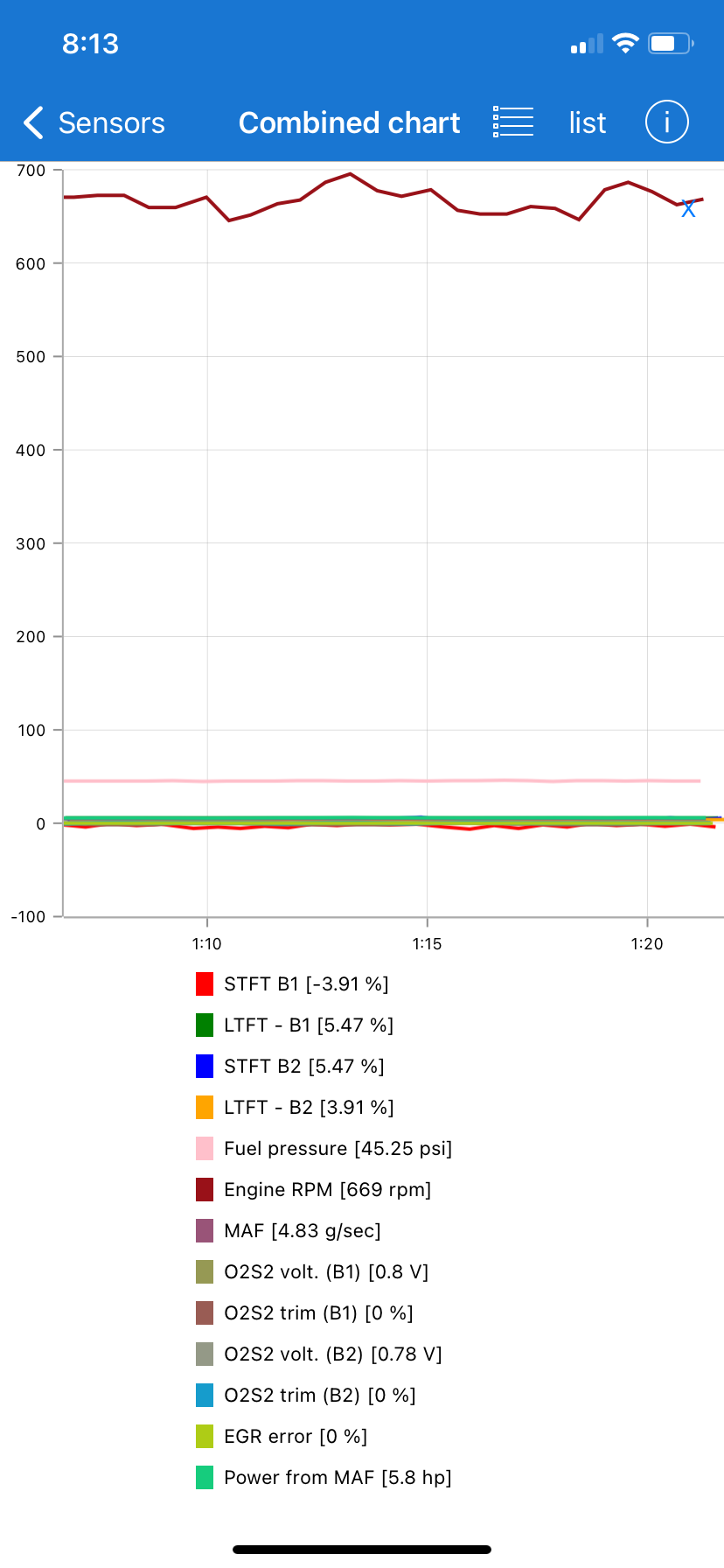

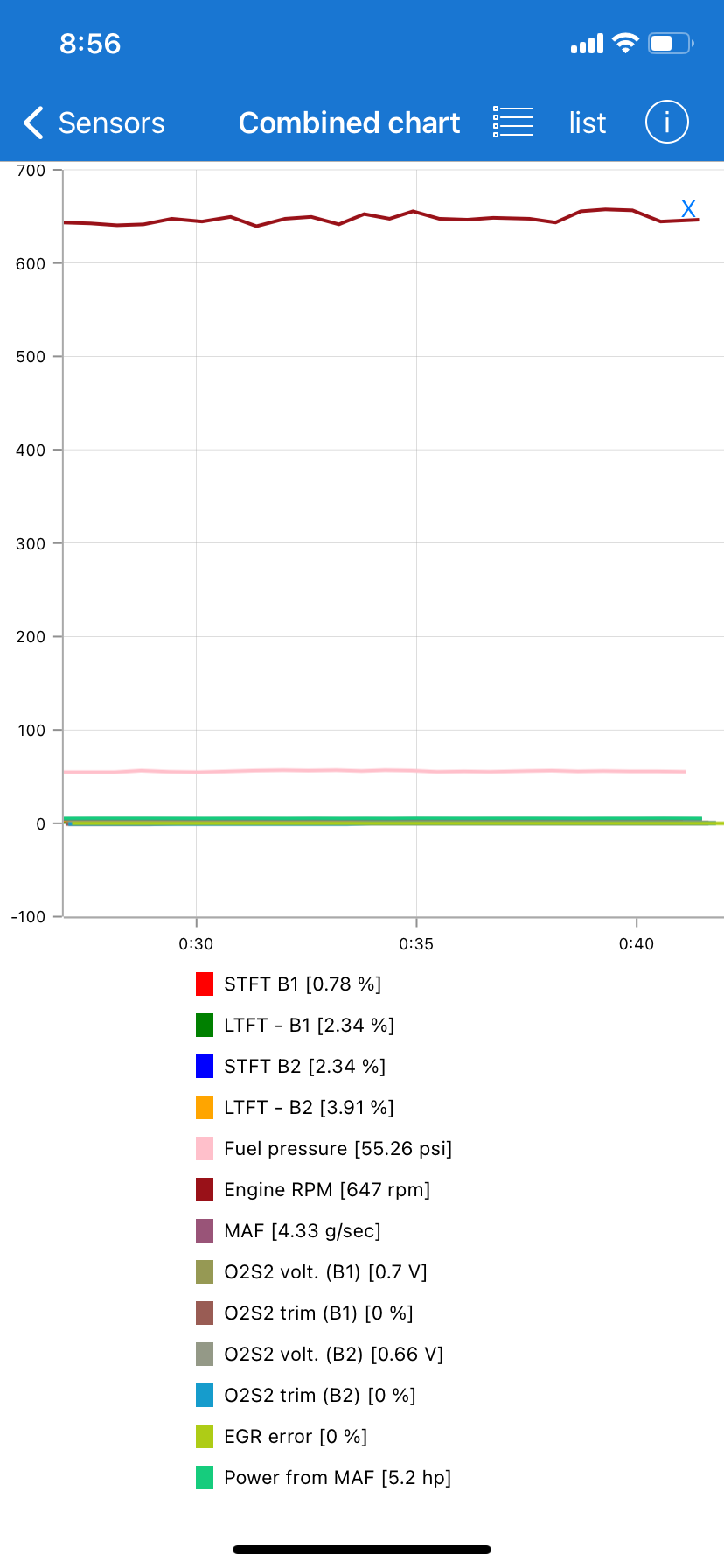

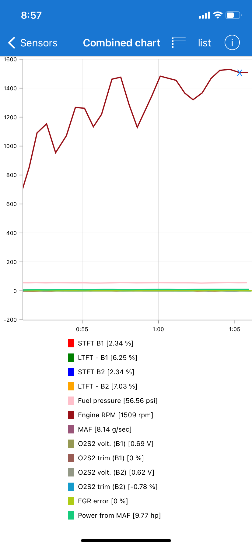

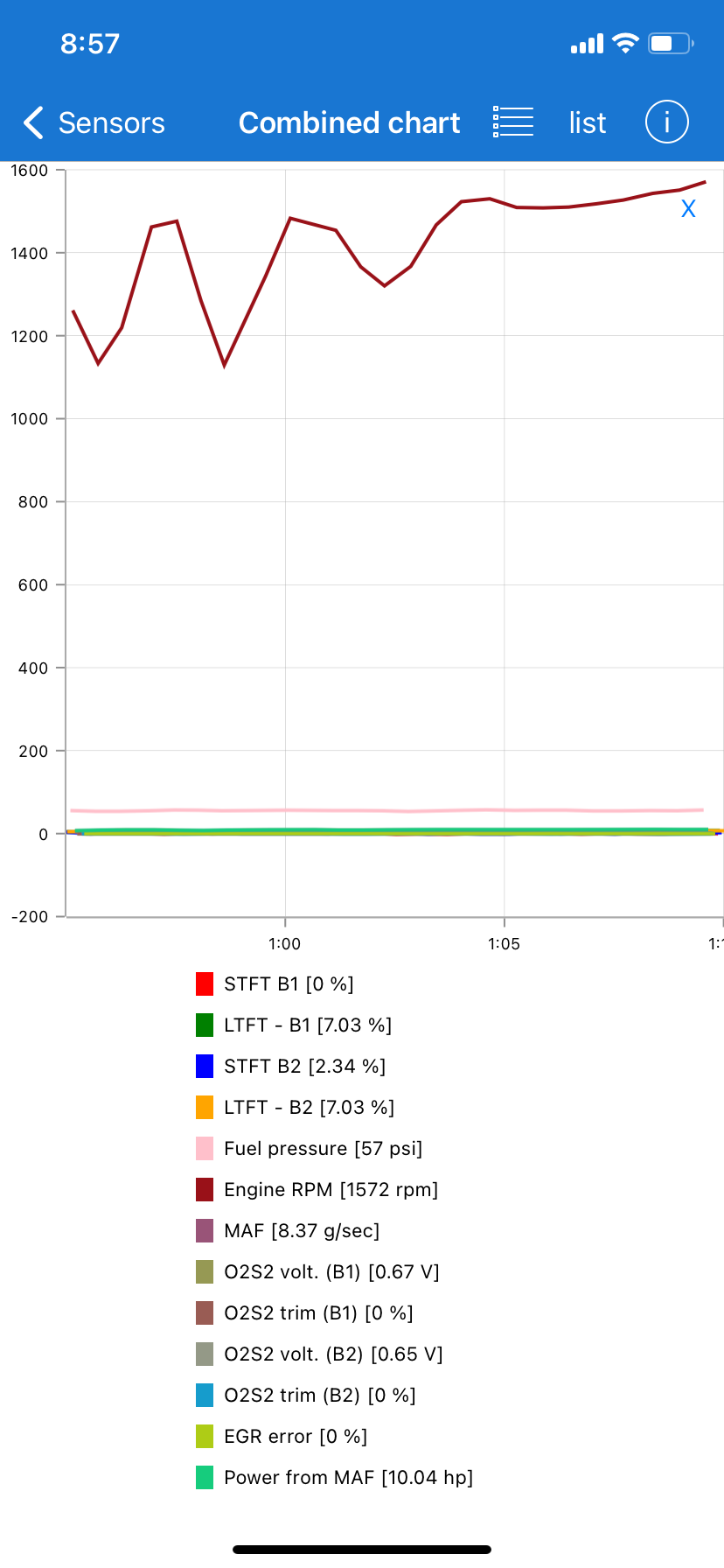

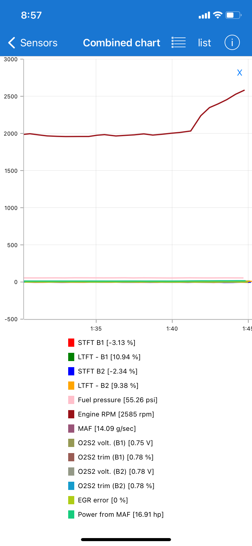

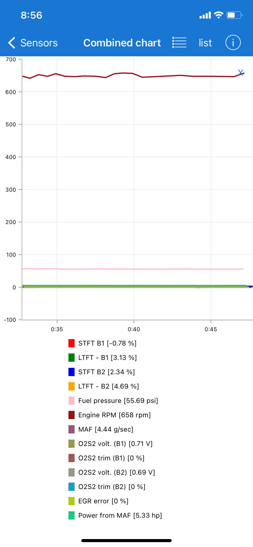

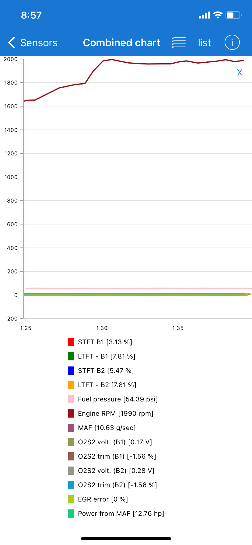

The CEL went off after i started pressing on the gas. I have captured some stats
Idle/CEL on
IDLE/ CEL OFF
Difficult to steady RPM. Below are some captures at a steady rpm. CEL Off.

If engine was hot the MAF is probably misreading - dirty very probably & might clean.
With an air leak you'd expect the LTFTs at high revs to drop near 0.
If the engine wasn't fully warmed up then forget all the readings.
Thank you. Engine was definitely warm in the readings taken at 8:57. The CEL has not returned yet. I will get the MAF clean.

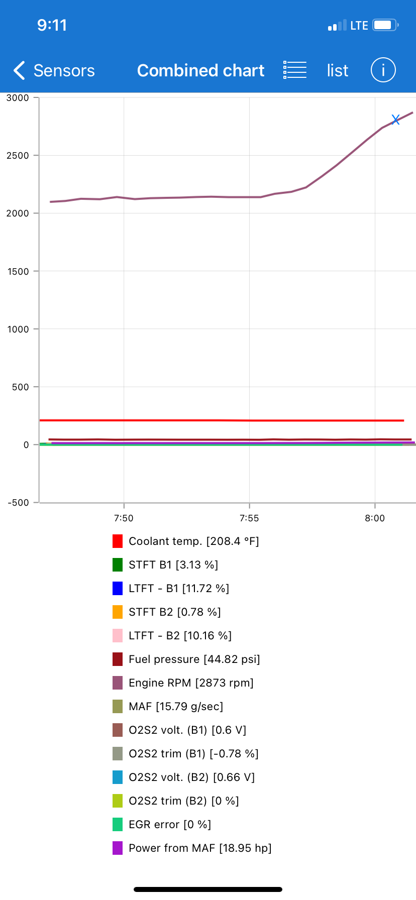

Please see another round of data, engine is warmed up. I have not taken any action yet. Is it better to change the MAF sensor or clean it? Thank you

I can't see how those graphs help. Read other threads on your codes and follow them. You're drowning in data.
