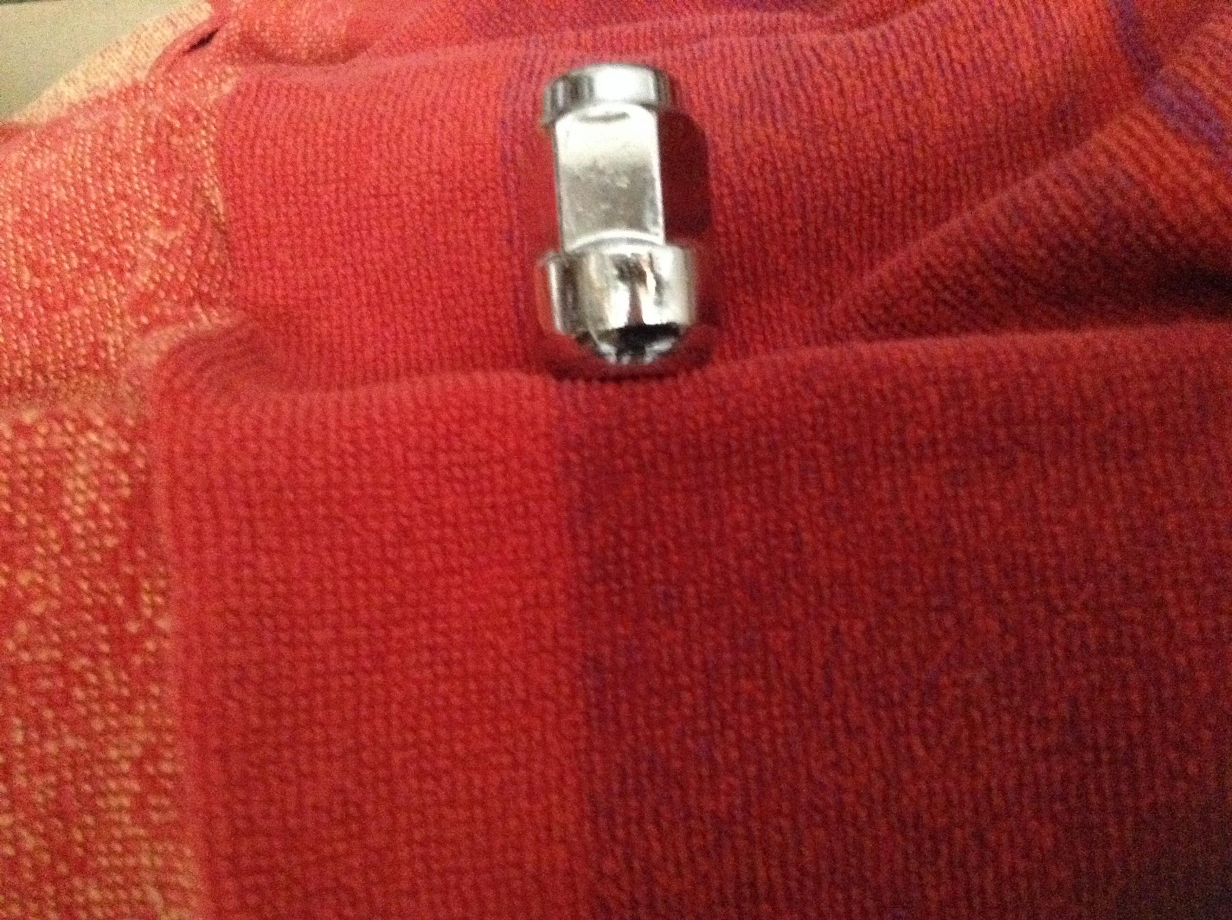

Good grief, a whole bunch of new information - thank you all.
I bought new lug nuts 4 years ago, just wanted solid non-rust lugs, never realized there were different types for OEM and non-OEM wheels.
I have OEM wheels. Here is a pic of one of my lug nuts. Can anyone tell for sure whether or not I have the correct lug nuts? It sure does not look like I do.
Robin,
It looks like you are toast.

Those are wrong for OEM wheels Robin. 4 years you say?

Well, better late than too late. Yep, been 4 years, no problems whatsoever, even changed from all-season to winter and (soon) back again. No one noticed, no one commented, but hardly surprising, all glad to see the end of OEM lugs.
Thanks to all. Really glad the roads in BC are good quality. Gonna fix this in short order.
