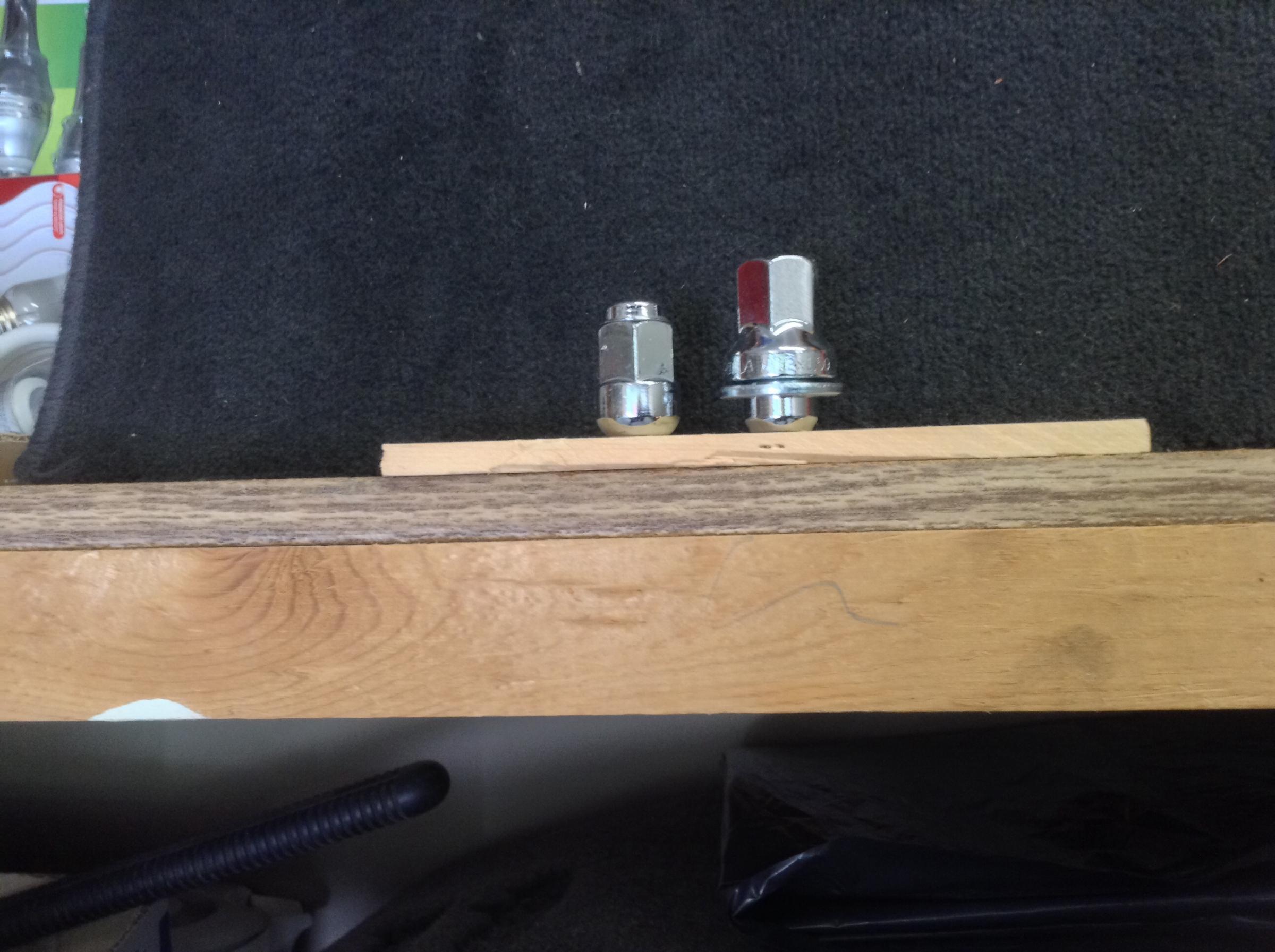

Old Apr 18, 2015 | 10:35 AM
  #52
Robinb's Avatar
Posts: 880
Likes: 182
From: BC Canada
Default Boy, was I lucky
Well, the Gorilla lug nuts finally arrived. Took one look and realized how lucky I have been! Pic shows Gorilla on right, other on left. Holy sh*t. Big diff!
