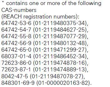

I have not been able to find a Material Safety Data Sheet for Mannol AG55 that discloses its base oils, so I have not been able to compare it to the three fluids we know are correct for the 6HP26: ZF Lifeguard 6, Ford Motorcraft Mercon SP, and Shell Spirax S4 ATF MSP (collectively I'll refer to these as "LG6"). The AG55 additives disclosed on its MSDS are different from those shown on various LG6 sheets.
Mannol AG55 is a low-viscosity ATF, with a published viscosity of 28.3 Cst (mm2/sec) at 40C and 6.07 Cst at 100C. But the published viscosity of LG6 is even lower, just 26.8 Cst at 40C and 5.6 Cst at 100C. This suggests that the base oil or base oil mixture of Mannol AG55 is different than that of LG6. From one of the LG6 MSDSs, the base oils of LG6 include one or more of the following:
ZF Lifeguard 6 is manufactured by Royal Dutch Shell in Belgium and is marketed by Shell as Spirax S4 ATF MSP/Ford SP. It is marketed by Jaguar under various part numbers It is approved by ZF for use in the 6HP26.
Ford Motorcraft Mercon SP is manufactured by Shell Energy North America in Houston, Texas, and is approved by Ford for use in the Ford versions of the 6HP26 (6SHP26, 6R60, 6R80). Early Mercon SP MSDSs give its color as brown (like LG6), but later ones give its color as red. Our member Box has suggested that this change occurred at the request of Ford so Mercon SP could be better distinguished from other fluids.
If anyone can find an MSDS for Mannol AG55 that discloses its base oils I would love to know.
