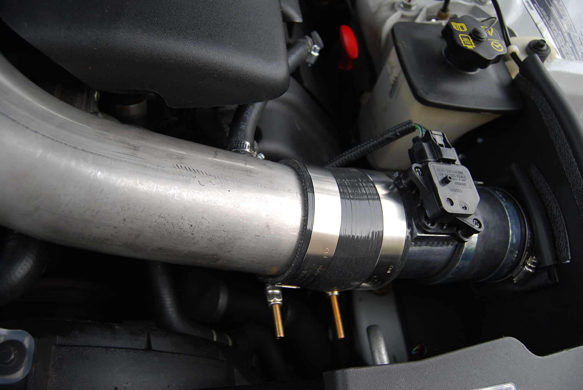

Here is my set up on the XJR, as you can see i am running the Mina to the intake tube. have driven the car more today and no more codes. as you can see from the Pictures the cone is a bit big for the space that is created by the shield.

So driven car for 3 days no problem then today engine light then Restricted performance, but strangely no performance drop! Will plug in the OBD tomorow but thinking standard box back on, had no problems with standard box and K&N filter. Mina tested the intake with standard tube not our intake tubes could be the airflow is too much and is throwing the system.

So update, Chris from Mina sent me a new tube for the MAF all metal to replace the metal/plastic one, fitted today and drove about 50 miles. So far no codes especially the bank 1 lean. Still not sure this is fixed will see over the next week.

Codes back and restricted performance on way to a cars and coffee meet this morning! Got home put standard box back on with my intake tube and K&N panel, have driven the last hour or so and no Codes or restricted performance. I give up and will keep the set up as is. My car must just not like the airflow.

So standard box and K&N panel been back on for 2 days no codes no restricted performance or lean codes any ideas chaps? I have bought so many clamps is crazy they where done up so tight I actually broke one. MAF was installed properly so I am confident that instal was good. My car must just be one of the odd ones that does not like some stuff, I know people who cannot even run a K&N panel without codes so stick to Paper. Perhaps after 9yrs Ronnie's computer can't compensate enough for the improved airflow I don't know anyway the Mina intake is off, not saying this is a bad product in anyway and Chris at Mina is great but Ronnie just does not like it. Have to report that car is running great but suppose I will have to take off the nice Mina Gallery Badge from the back of the car.

Just one thing to point out, my kit came with a large cone filter that is really too big for the space do fit it. How big and what shape are everyone else's filters? Did hear that some incorrect filters had gone out, would this make a difference?
