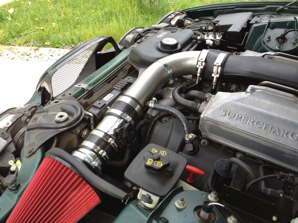

Robert,
I hope you don't mind, but I'm using one of your pictures for reference. I started installing my Mina Intake today and noticed that the silicone coupling is too large for the MAF tube (see the circle I added to Robert's picture). Since we both have the Qwiketz intake tube, the coupling goes from 3" to 3.25" to fit over the MAF connector from the stock airbox. I'm wondering if that's where you're getting your leak. I'm going to replace my 3-3.25" coupling with a straight 3" coupling before firing my STR up bought wanted to post my initial observation.

Hi go blue, there was no gap as my MAF tube had a rubber gasket on that end which compressed completely with the clamps so no gap there, we then tried another MAF housing sent from Mina with the same results. The codes that are happening now are with the Stock box back on with the elbow so the Mina is no longer involved even. What I am trying to find out now is why my car will no longer run without codes or restricted performance which it did before.

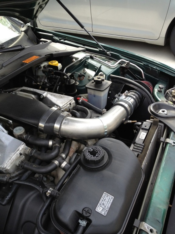

Just finished installing my Mina intake...
I replaced the 3/3.25" coupler with a 3/3 and enlarged the hole in the heat shield a little. Overall it was an easy install. I drove it around the neighborhood and so far no Cel... Will go on a more spirited test drive later this evening.
Attached Thumbnails Mina Gallery Intake-2ea15127-5359-407e-b9e2-5f1d9415c3dd-1378-00000074dbba89f4_zpsbe29b22d.jpg   Mina Gallery Intake-6d301439-6b1b-40a9-a16f-16e03dd7ef67-1378-00000074c5522880_zps886154f0.jpg   Mina Gallery Intake-471e3605-88b9-4faa-9e97-0d9fd59fab50-1378-00000074b7a21780_zps89e7b860.jpg
