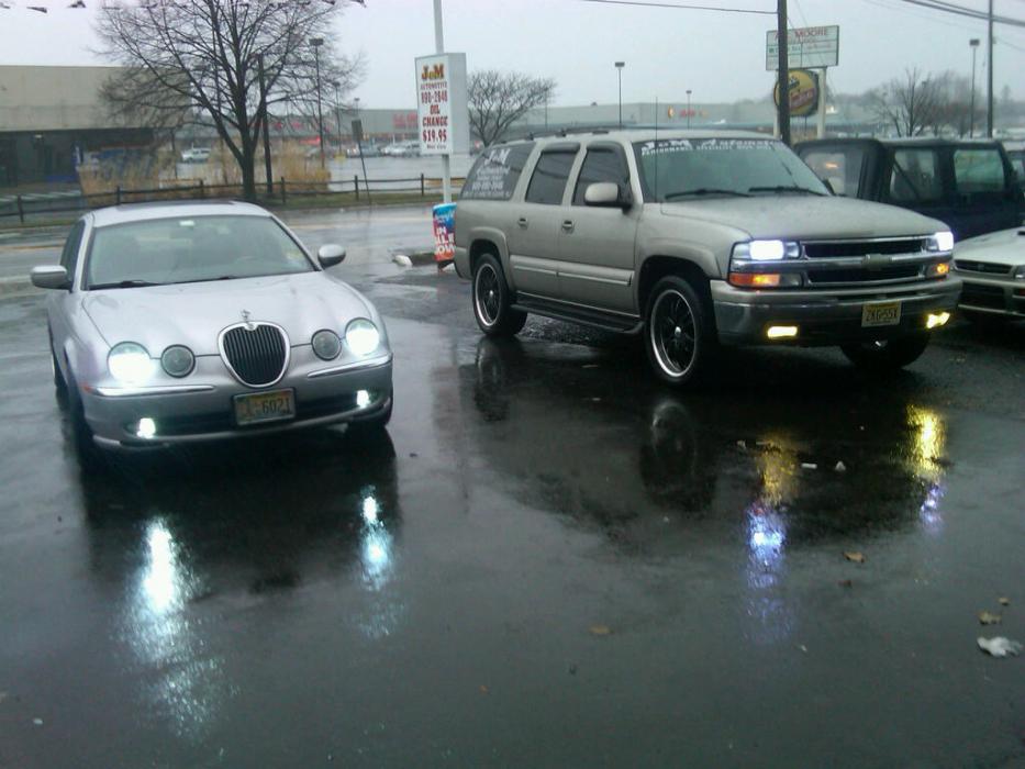

And here's a pic of what headlight / fog hid looks like...
This was one of the first mods I did to my car, so the grill is still stock in these pics etc...
Take care,
George

ooohhh ...awesome...guess i have a project.......curious now as to why mina would sell these bulbs if they are not safe, and now looking again, it states these are 130w bulbs!!
