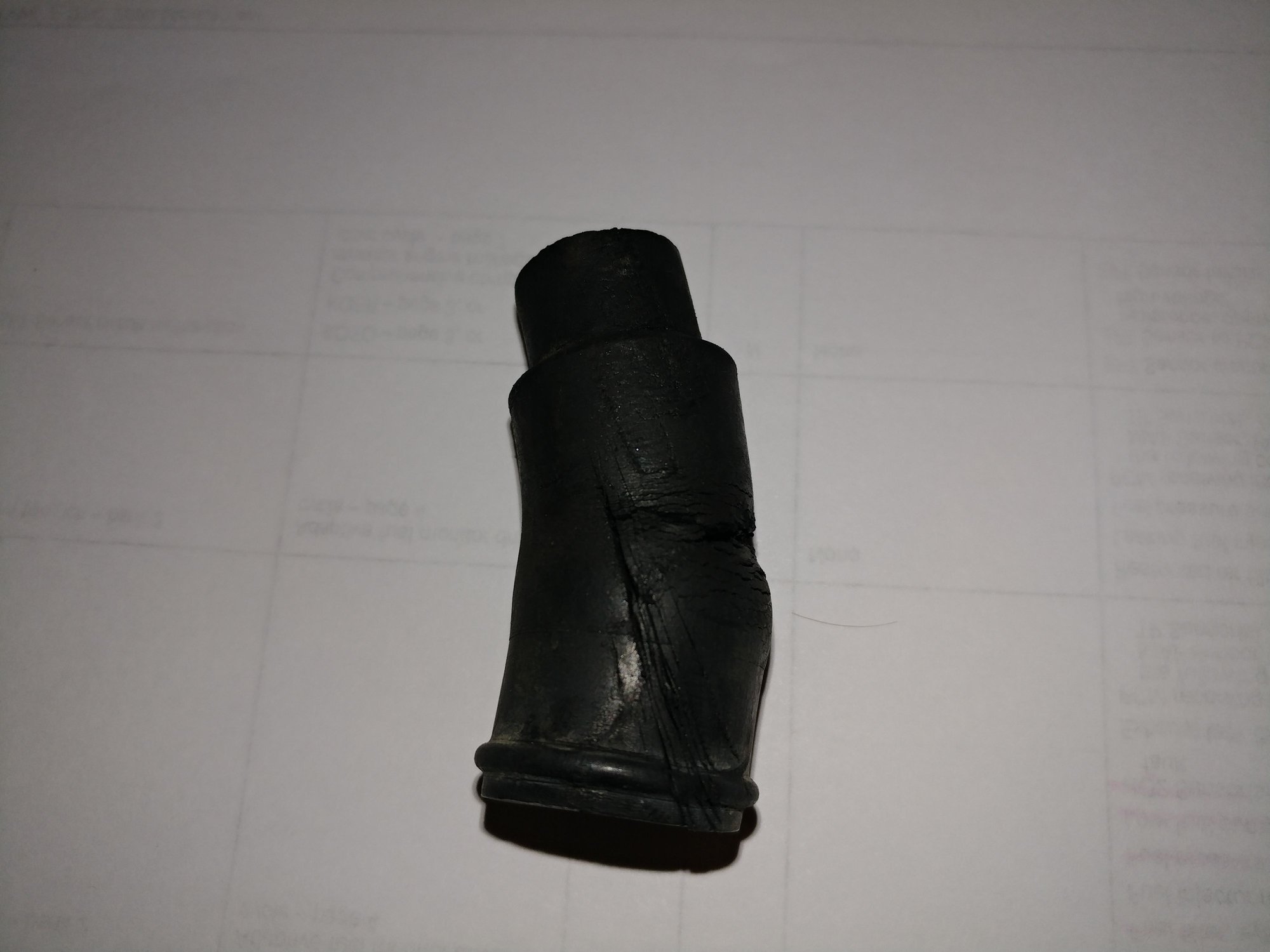

OK, for the top rear hose part I can't seem to track down the part you have listed: Part # CS250039 - Rubber Connector.
I *can* find this part rubber connector XR819733 on the JEPC which on the exploded diagram looks correct. I'm just waiting for my local dealers parts department to call me back, maybe they can confirm.
Steve

Sorry, I posted the number wrong. When I found it, it was identified with the number I posted making it impossible to find. The correct number is C2S50039
Connector slightly bent after pulling during removal. Failure on right side.
Firewall area. 90 deg elbow removed.

Hi, yes, thanks for the pics, I took my pipe off - had to use a sharp knife,,,,, but it was a good call as the inside was perished and although possibly not leaking it was also not long for the world!
Collecting a new one tomorrow along with the elbow that fits into it and the top plastic vacuum pipe as that was a very slack fit and at £6.00 seems well worth it.
