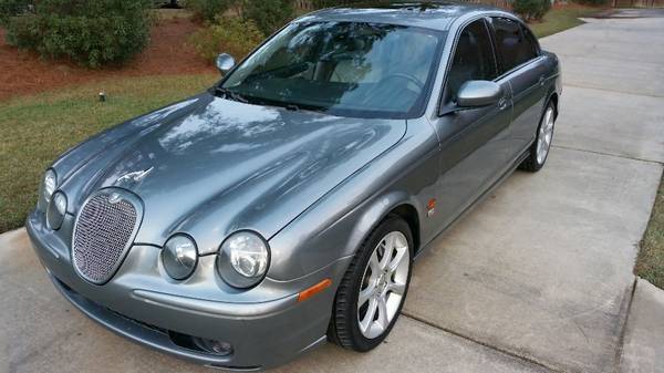

Aside from the annoying tranny LURCH I am loving my 2003 STR. I've never owned anything this nice or this powerful. I am the second owner. It has 120k miles on it and has been well cared for by the original owner. There are a few issues other than the LURCH (plan to try the reboot method and follow steps tomorrow) that I could use some advice on.
1. Dead stop take off is hindered very badly with/without Trac control on and/or sport mode.
2. Headlights droop. Went to do the screw method but it's already been done yet low beams still shine only 15ft on the ground.
3. Small Coolant leak somewhere around the resivior. I think it's the small hose on the top left.
4. Key fob controls don't work, have to use the key in the door to lock/unlock.
