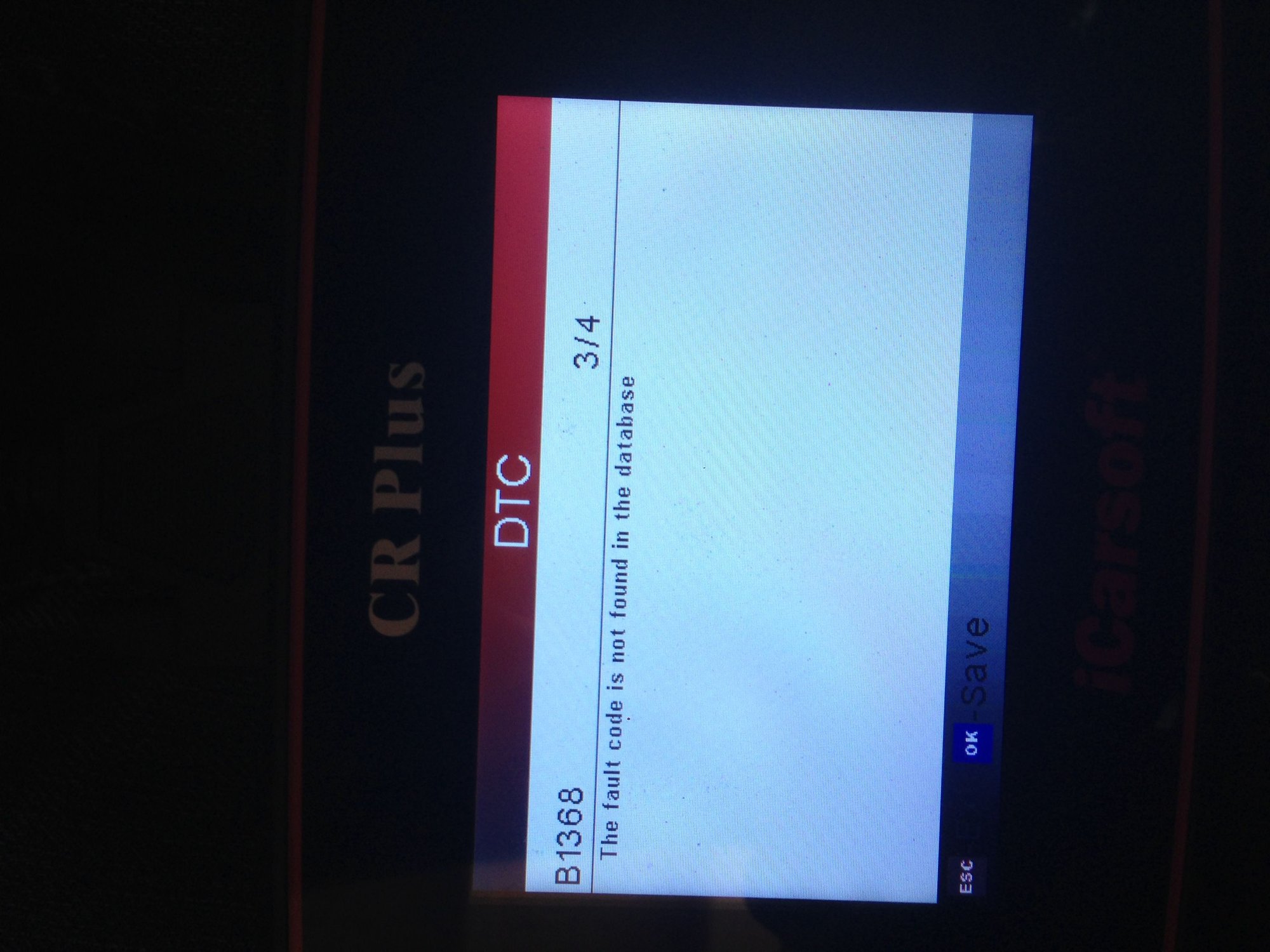

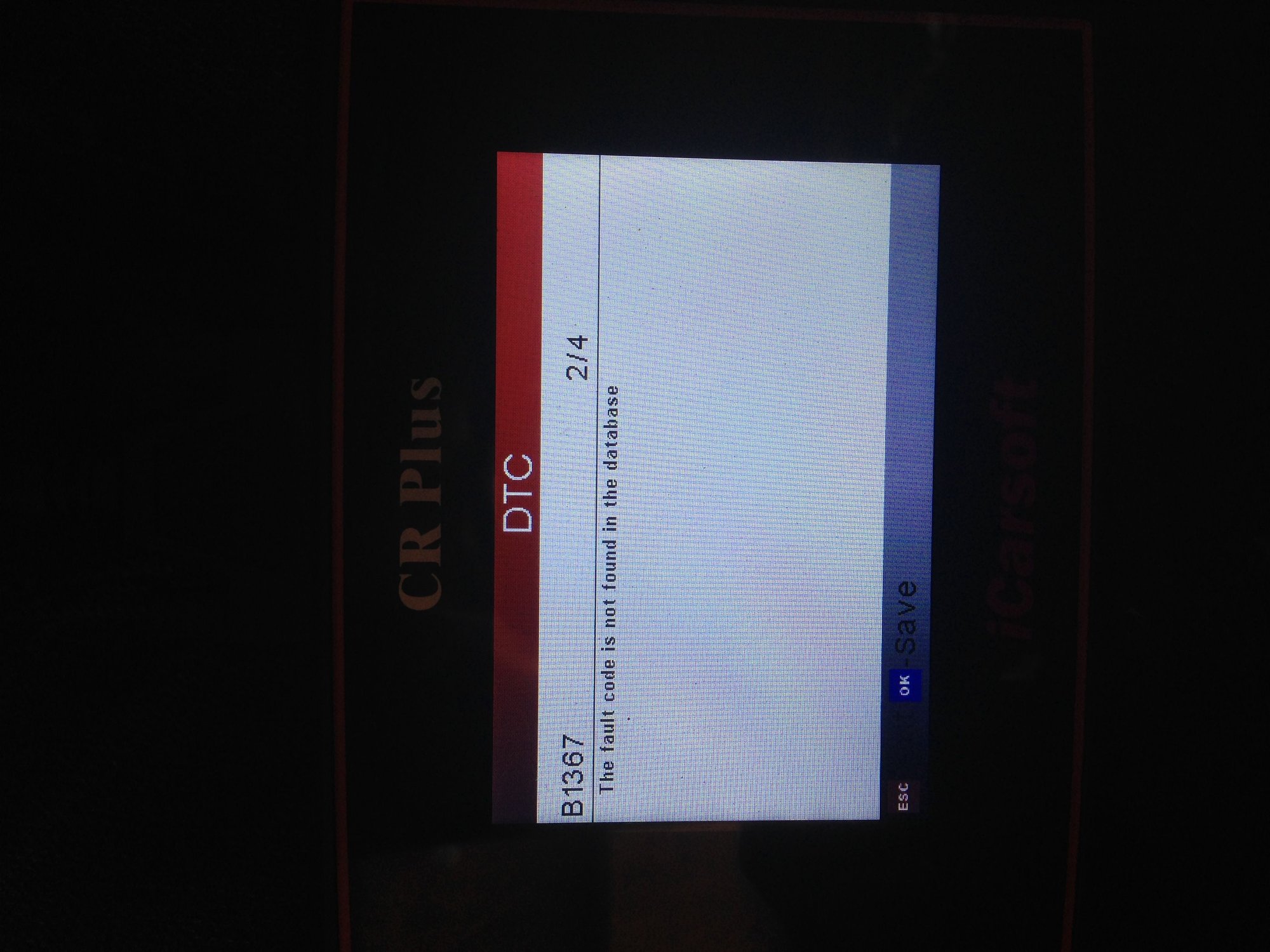

Could those be P not B?
I'm not find the ones you posted.
Old Apr 19, 2020 | 08:20 AM
michel.guygrand's Avatar
Joined: Mar 2020
Posts: 20
Likes: 7
From: FRANCE
I confirm B1367 and B1368
I don't find lot of information about this
Old Apr 19, 2020 | 08:36 AM
JagV8's Avatar
Posts: 27,532
Likes: 4,915
From: Yorkshire, England
It's almost like the tool is getting them wrong.

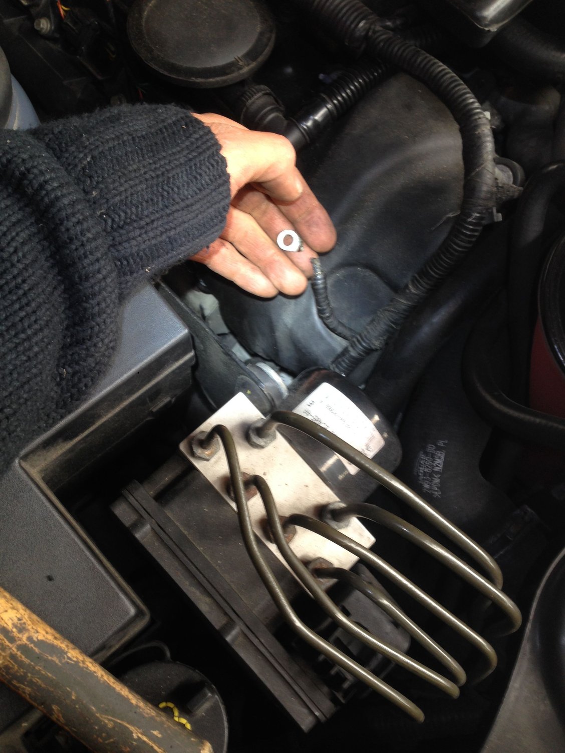

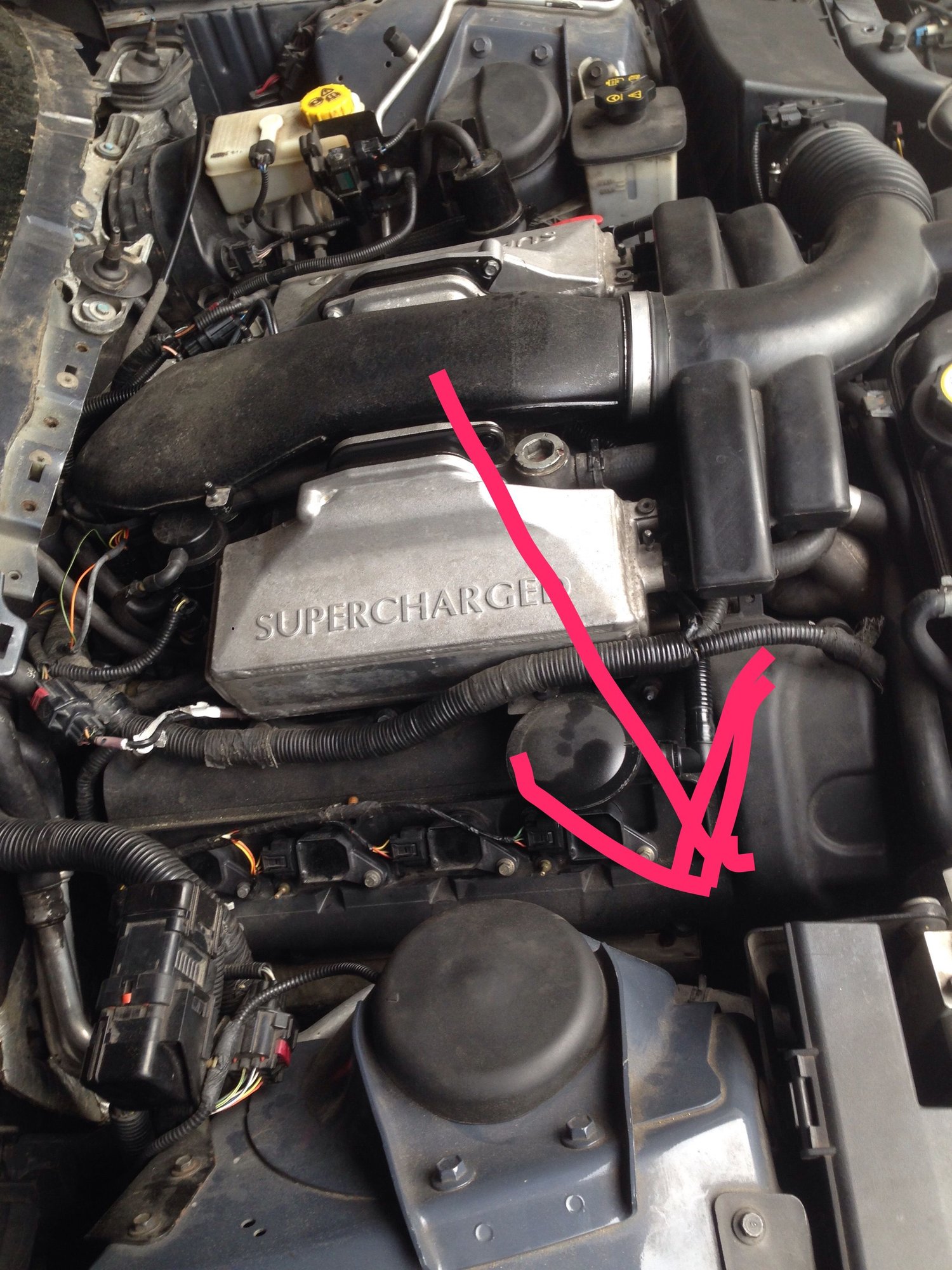

Hi my friends,
today is a beautiful day.
I find this :
after a réparation, my STR purrs like a big cat !!!
Thank you very much for you help !!
I run to my garage reassemble plastics and other and go on the road !!
Old Apr 19, 2020 | 01:01 PM
JagV8's Avatar
Posts: 27,532
Likes: 4,915
Good! But what is it?
Old Apr 19, 2020 | 02:06 PM
Joined: Mar 2020
Posts: 20
Likes: 7
From: FRANCE
This is a little ground wire, it is on a M6 bolt of the rocker cover

The ground is in this bolt

Wow good find and excellent troubleshooting!
But I have to ask as you said you were driving and the engine just died.
How could the ground lug become disconnected from that bolt while you were driving?
The connection did not look damaged?
Old Apr 21, 2020 | 06:20 PM
  #31
scottjh9's Avatar
Joined: May 2018
Posts: 2,150
Likes: 760
From: california
wow great find....i bet it was on the stud loose and popped off....more than likely the coil grounds or something similar that would make the engine no spark or fuel.....enjoy
Old Apr 26, 2020 | 02:13 AM
  #32
Joined: Mar 2020
Posts: 20
Likes: 7
From: FRANCE
I do the photo after unscrew the bolt.
the terminal electric was broken, sometime the wire may touch the bolt so my jaguar was starting....
