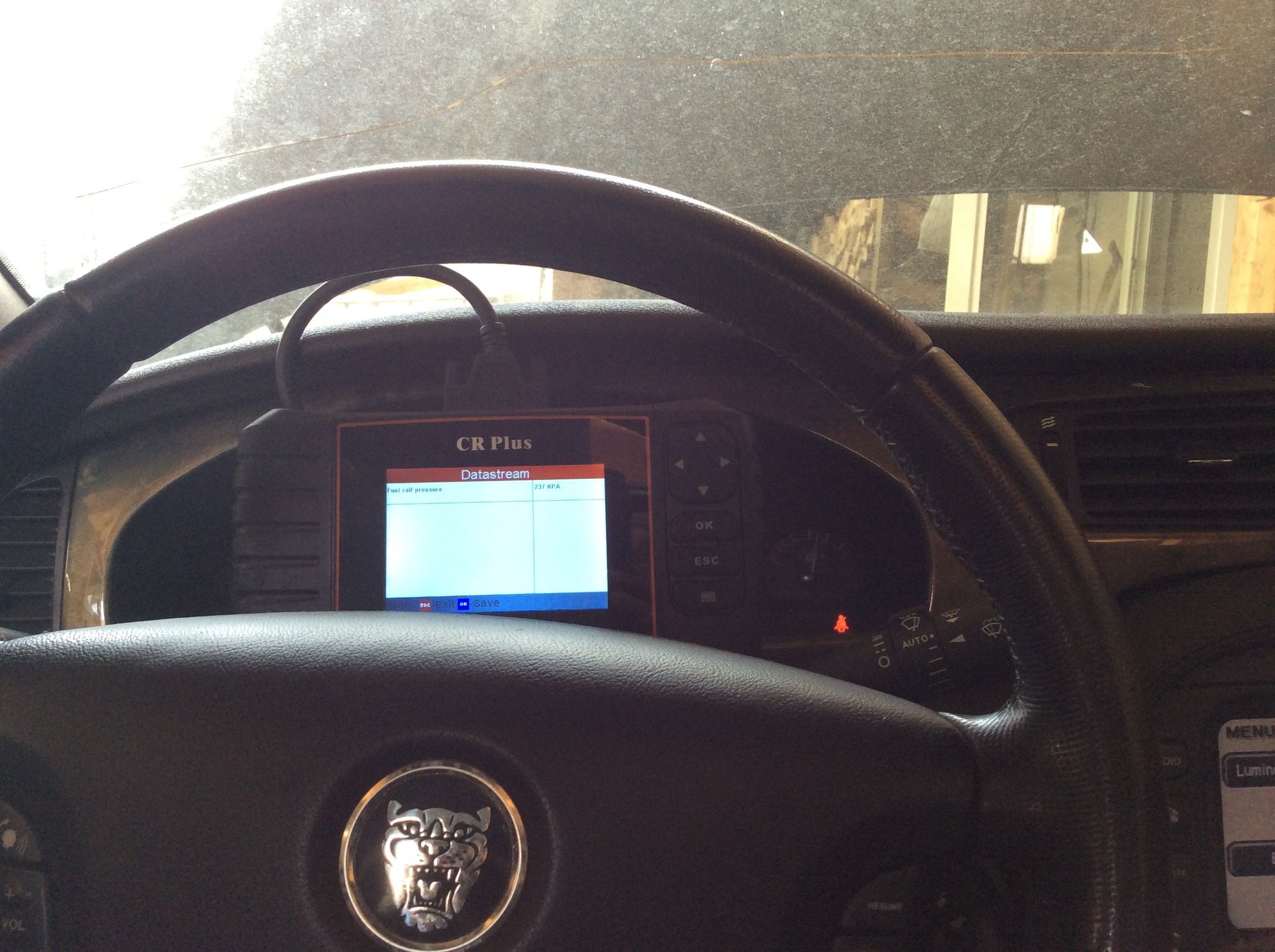

My OBD reader

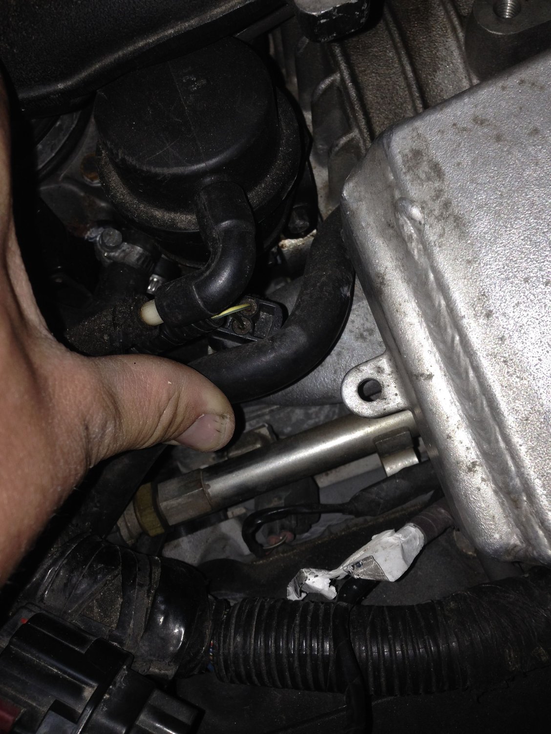

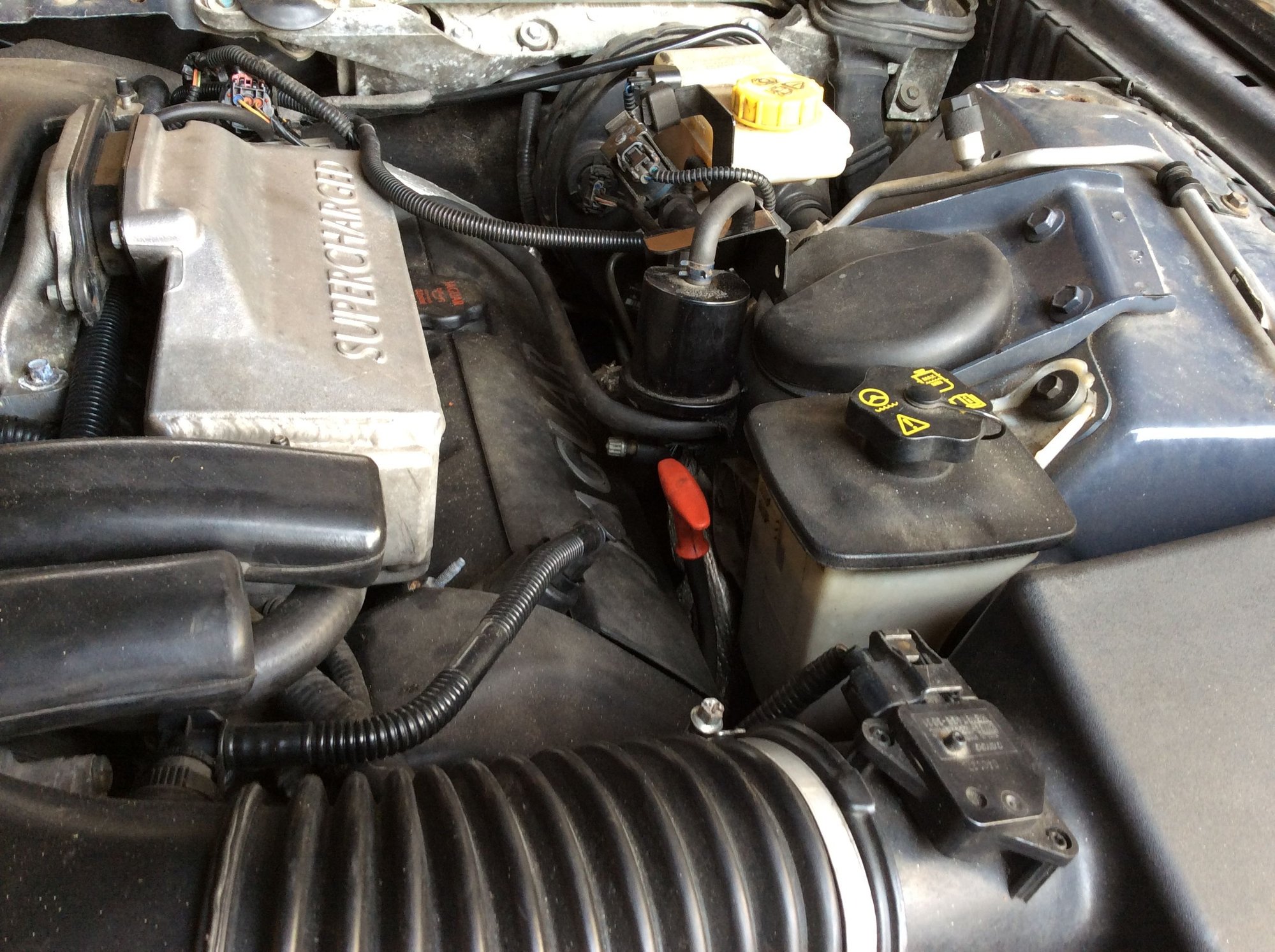

I wonder if you are asking if the valve cap in your photo is the Schrader valve?
if this was a question then no it is not it !
that is for air conditioning.
the fuel rail is on the engine with
a (in my case) blue valve cap.
rear r/h side of the engine .

Ok thank you for your picture.
after such in my engine bay and in the forum, some car has no schrader valve in fuel line, like mine.
No problem I will remove a sensor (fuel temperature or fuel pressure) to take the pressure.

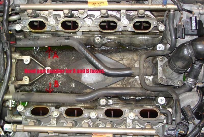

hay buddy ,
this is a location i have not seen before .
, try here
again shown here on a supercharged ajv8 in this location .
photos stolen from these forums .
