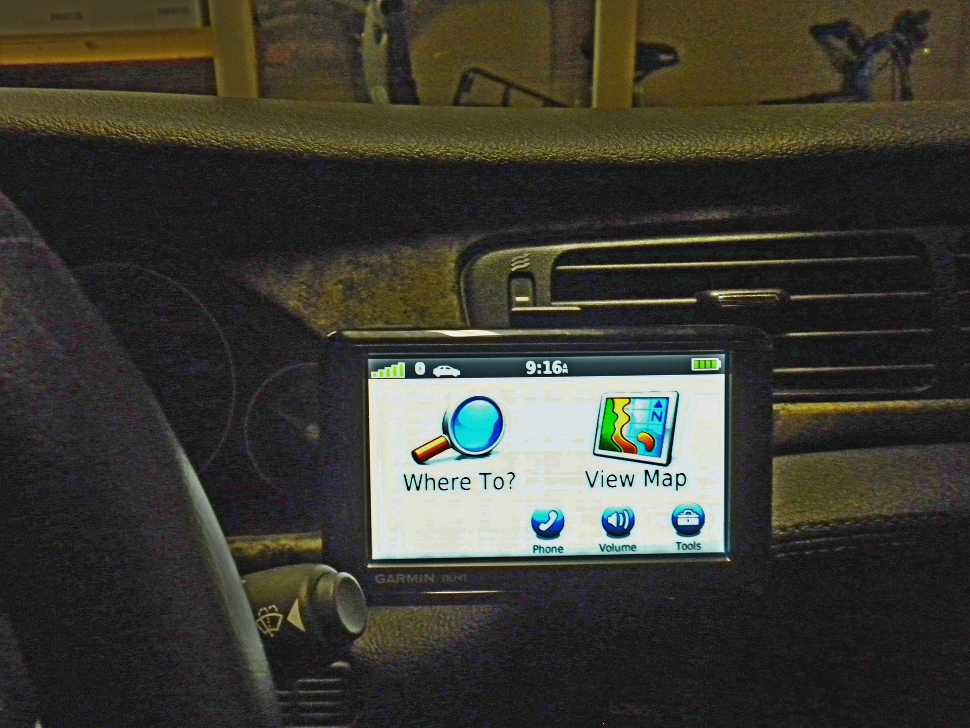

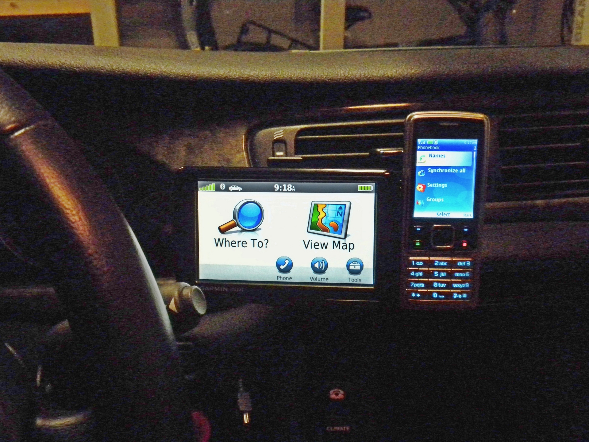

Initially, I was full of enthusiasm for the NAV system. Even bought an update DVD from eBay.
  1. Then I read the manual. Too complex for my liking.
  2. Then I found that the street where my daughter and son-in-law live in Calgary did not exist in the NAV, but was there on my Garmin.
  3. Then I realized that I had to take my eyes off the road and look at the map to double-check the verbal instructions - OK in the country, but in the city, when you need to differentiate between "Bear left", "Stay left", "Keep left" and "Turn left", it's nice to have a clear road map right in front of your eyes.
  4. Then, one dark and rainy night in the middle of nowhere I heard the instruction "in four-tenths of a mile, take the turn on the left".

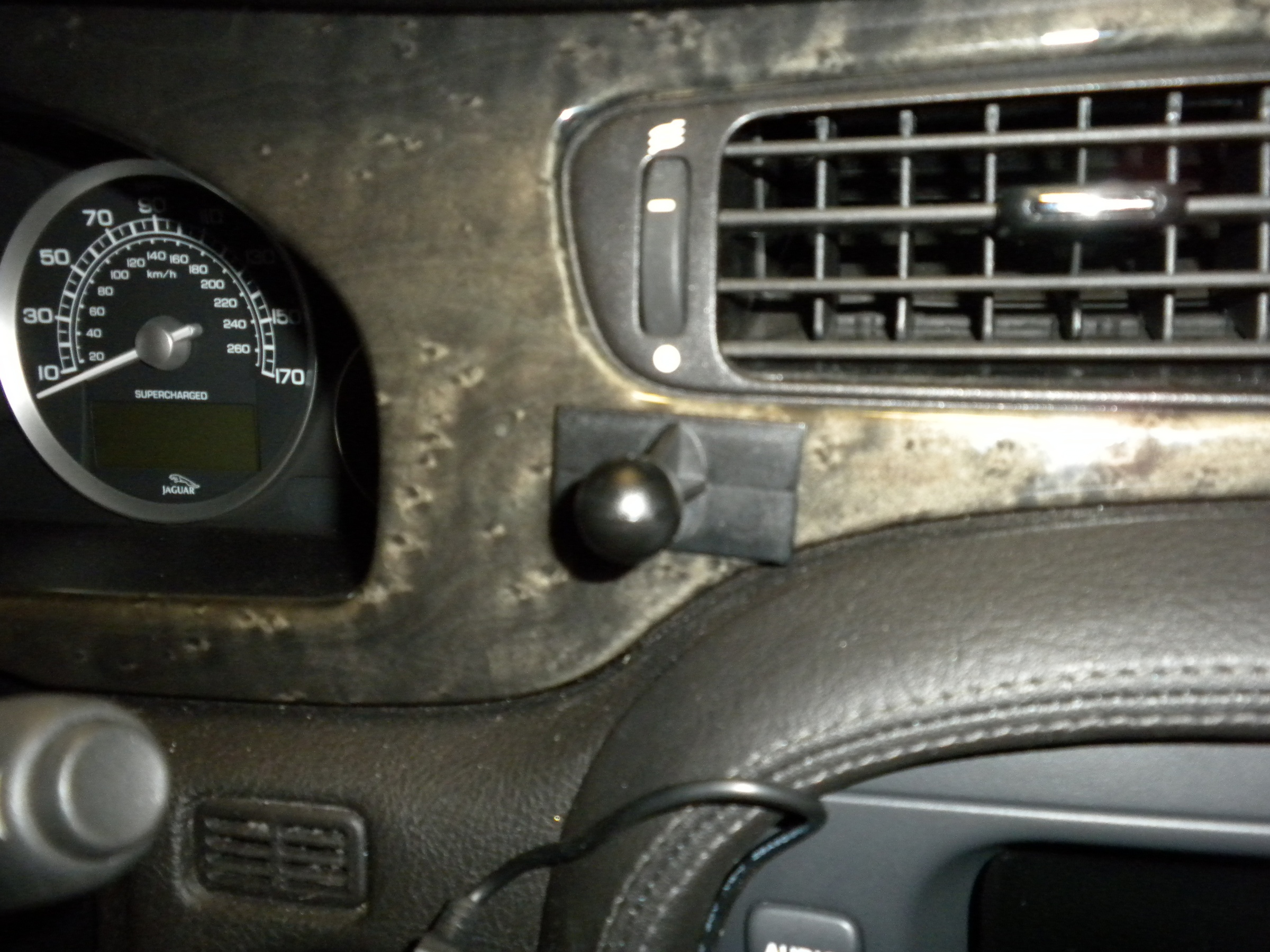

About that time, I decided to use the Garmin instead. Cost $88, free lifetime maps, bluetooth hands-free voice-activated cell-phone control, mounting bracket $8 from ebay, sticky pad attachment easily removable, cell-phone attached to GPS with velcro, wiring hidden all the way to USB-power in the cigarette lighter, 5 minutes to install. For the time being, perfect!!
Hope the pics will give you an idea.

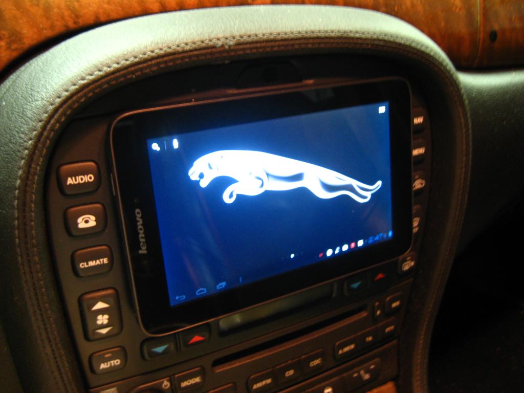

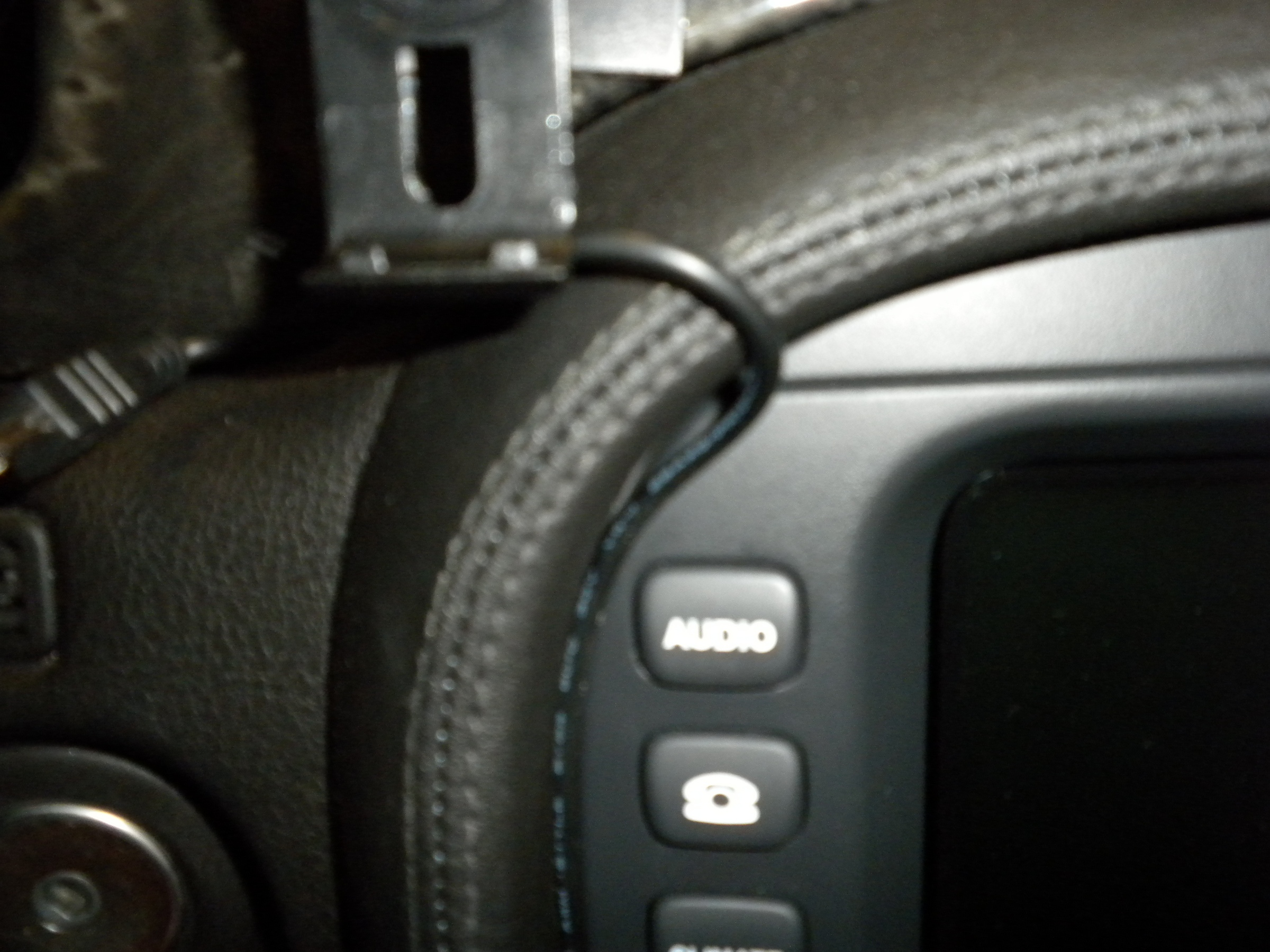

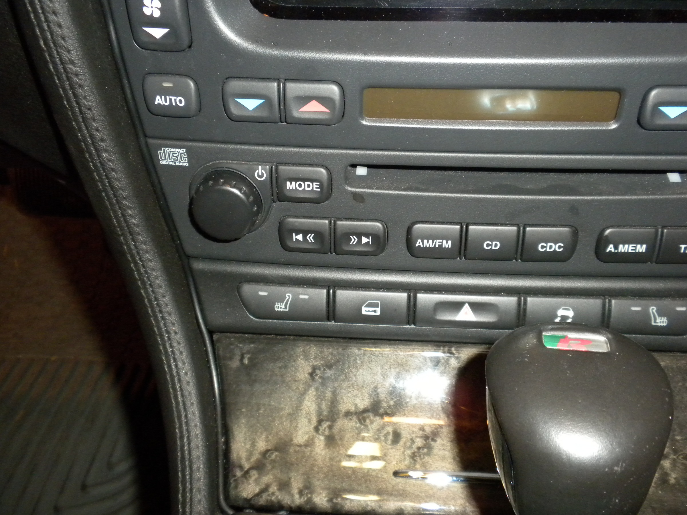

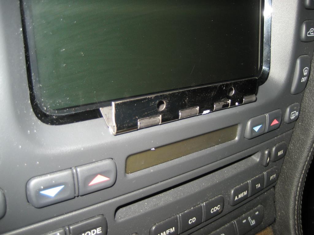

Ok, here we go. To make the tablet removable, I decided that a set of neodymium magnets should do the trick. They are very strong for their size. 1/4" diameter x 1/8" thick is the size I found at a local craft store. I figured 4 for the bottom attachment to the hinge and 2 for the "latch" at the top. I used JB Weld 2 part epoxy.
The small section of piano hinge was attached to the bezel of the SAT NAV screen with #M double sided tape. I ended up drilling 4 holes in the outer flange to give the magnets a place to "seat".
I don't mind the small magnets on the tablet as it's only life will be as part of the car display. The wire for charging plugs into the cigar lighter and will be stored in the sah tray when not needed. I plan to run an audio input from the tablet to the factory system through a switched input from the CD changer line. The switch will be in the center console next to my subwoofer volume control.
I think it looks good. (found a Jag logo to use as wallpaper) I plan on using my phone as a mobile hotspot for wifi when needed. The tablet has wifi and gps as well as bluetooth.
Total cost - about $150.00 Totally reversable to stock appearance with minimum effort.
