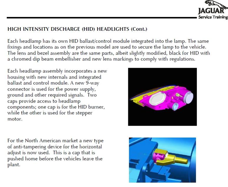

Am I correct to assume the igniter is the box on the back of the headlight assembly? And the ballast is the thin metal box mounted to the side? That was my understanding, but someone here mentioned the ballast was also called an igniter. ??
Anyway, I've replaced my bulb and igniter and the headlight is still out, so my next move is to replace the ballast also.

Are the ignitor and the ballasts in the same box?
They are totally different units with 2 totally different tasks.

I am pretty sure the igniter/ballast is all one unit, if similar to the XK8s
If you also go to JPLV website you will see the igniter is the only option to purchase.
