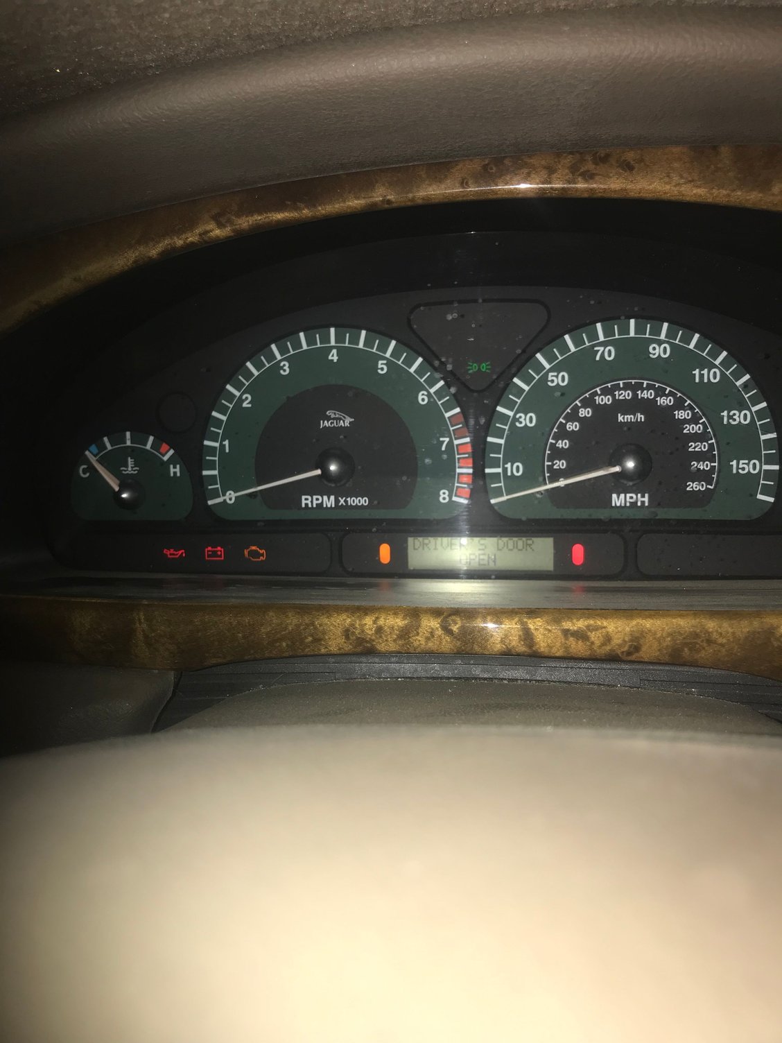

Oil, battery, and cel. Still on after installing fully charged battery.
The alarm light on dash was not staying on when I tried to start the car 10 minutes ago.

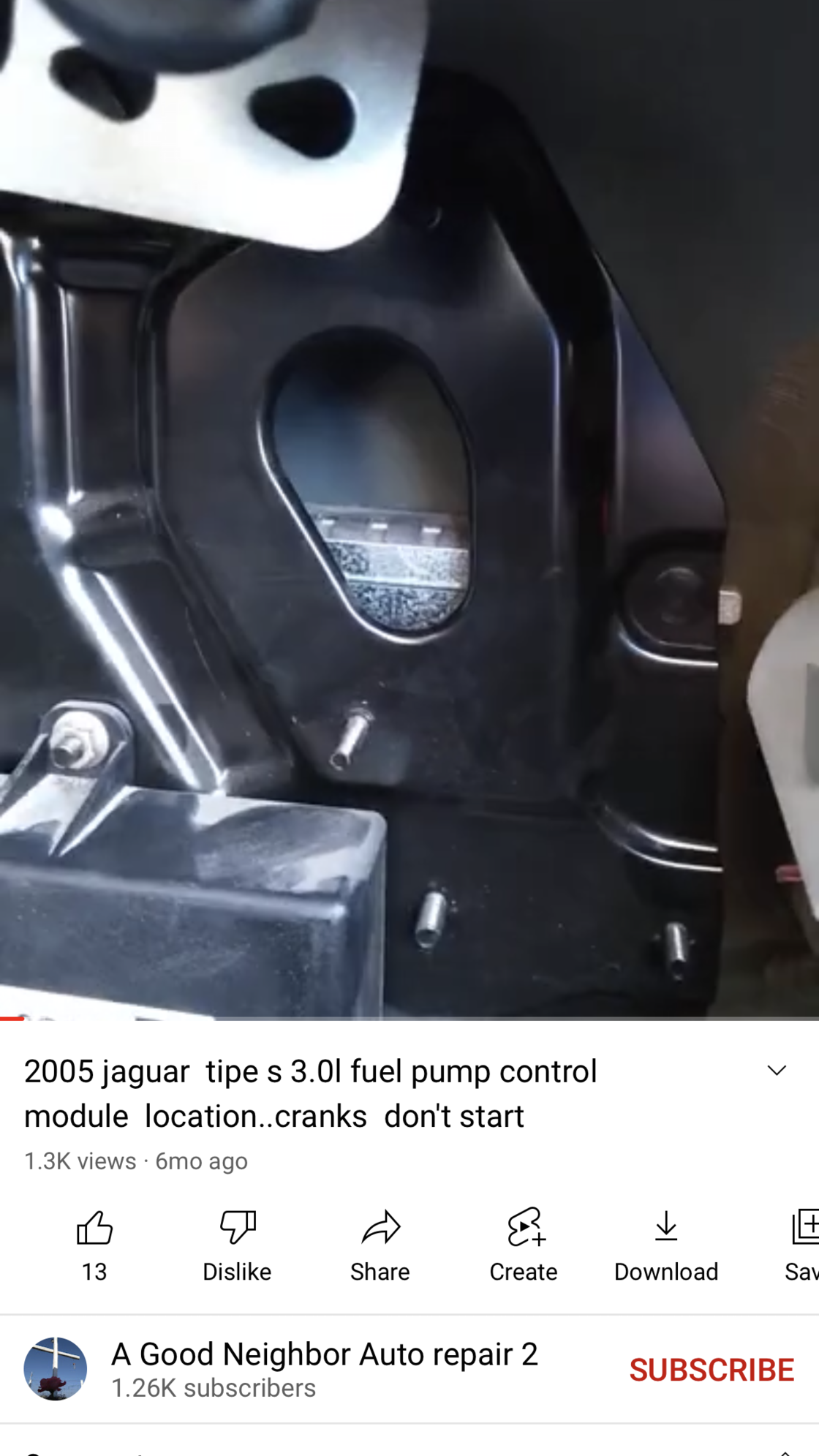

Could it be the fuel pump driver module?
sounds similar as this one was cranking but not starting…

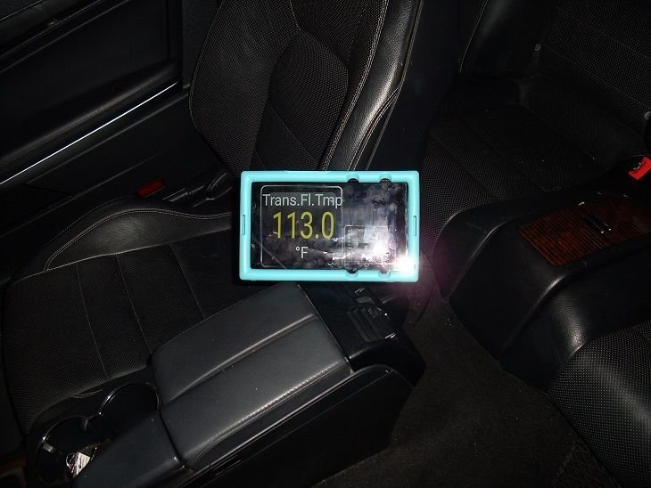

The thing that stands out and makes Torque Pro so valuable is the ability to add custom PIDS. We have a special setup for Jaguars courtesy of some fine forum members. This opens up an entire world of service stuff. Like a REAL engine temperature read out!
I have added some special MB PIDS too which allowed me to monitor transmission oil temperature in real time while I was changing the fluid. Working on a friends E350 and having the transmission temperature in large digits on my tablet which is sitting safely on my tool box while I am covered in transmission fluid and trying to fill a smoking hot car from underneath is really wonderful!!
I made a custom dashboard with only one large gauge - Transmission Fluid Temperature.

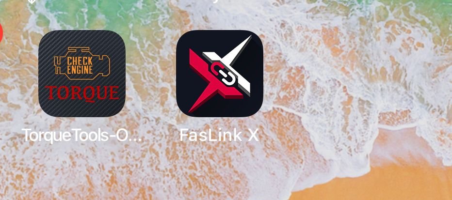

So far I’ve added these apps, but neither one has been able to pair to the elm327…
Old Dec 31, 2021 | 08:20 AM
  #38
clubairth1's Avatar
Community Influencer
Posts: 12,139
Likes: 3,386
From: home
Never used either of those so can't help.
Did the ELM327 come with any software? They usually do and it won't be very good but it should at least let you connect to the car and prove the ELM327 is working OK.
What does your phone say under the BT settings? I have to mess around a bit with that sometimes.
