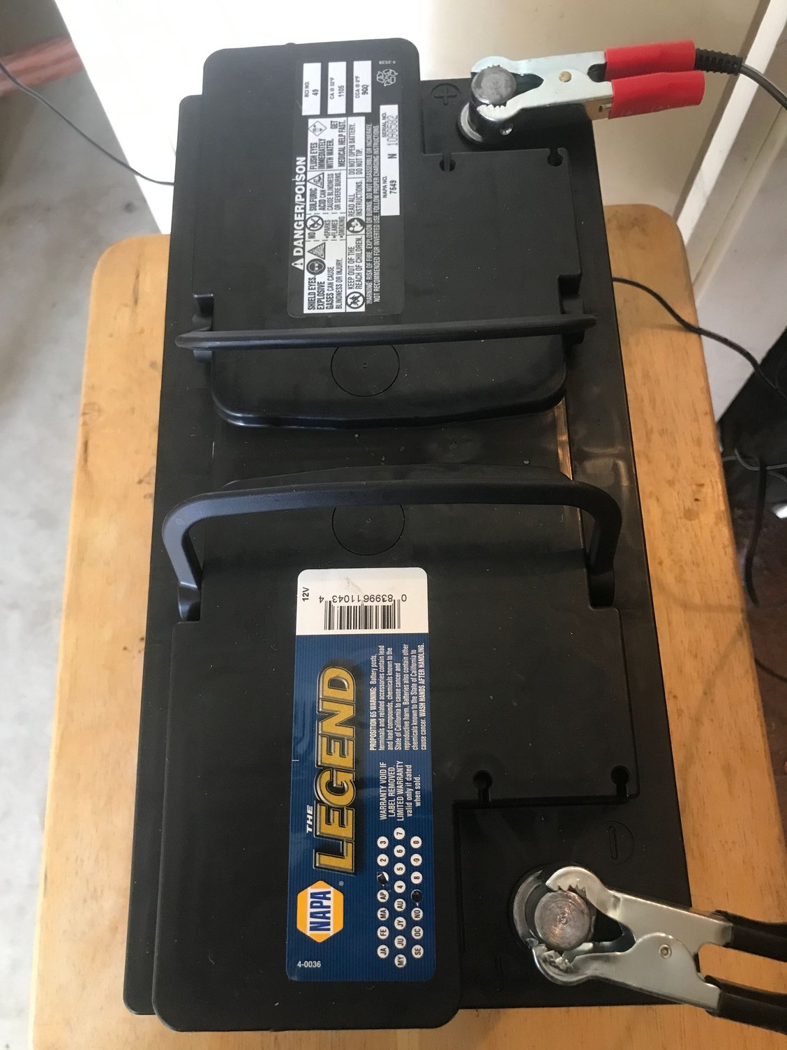

I have two batteries one was in the car when the no start happened. I took it out and had it tested it was at 12.3 volts, the brand new one is near 12.6 volts. That’s enough to start the car? Or do they need to charge more? The codes that popped up weren’t present while driving earlier in the day before no start issue…

Generally 12.6 volts and below is not enough to start these vehicles. I would charge them up.
Charge the battery to be sure. 12.3 is too low for sure. 12.6 is right at the lower limit, but is not conclusive of being good. Determining a battery's state of charge with a voltmeter is tricky business. I don't put a lot of stock in this method. Lots of variables, and it's easy to condemn a good battery and pass a marginal one. Ideally, you should take your voltage reading after turning on the headlights for about 15 seconds to dissipate any surface charge. This is a phenomenon where a battery at rest shows a relatively high voltage, but quickly drops off under load.
Also, be careful if trying to judge a battery's condition by observing starter speed. A generation ago, if the battery had enough oomph (sorry for the technical terms) to spin the starter at a reasonable clip, that was generally enough for a good start. But thanks to the presence of many computer modules on modern vehicles, even if the starter speed seems normal, that does not mean the battery was adequately charged. The 2003+ models are VERY susceptible to problems due to low prestart voltage, even if the starter speed seems okay.
Put the new battery on a charger just to be sure. I recommend an automatic charger with at least a ten amp output. A trickle charger won't cut it, so don't waste your time. If you don't have access to a charger, most auto part stores will charge your battery for free.

I have a Duralast 12v battery charger. I’m going to hook it up to the newer battery right now. Since it’s new I hope it doesn’t take too long to charge…

Brand new battery can’t even believe it’s not at full capacity because it indicates it’s taking a charge.

The car was cranking almost starting, but didn’t want to stress the starter too much… also I’m pretty sure I could hear the fuel pump engaging. Check engine light was on also battery light was on during no start. Battery is still charging once it’s complete and I put it back in I’ll be back on here to post results. Thanks for all the advice I really appreciate it.

Battery just finished charging. Installed and tried starting and had the same no start. Dash lights showing oil light, battery light, and check engine light. So I will start checking fuses, sensors, etc., tomorrow. Engine oil is topped off, battery is brand new and fully charged.

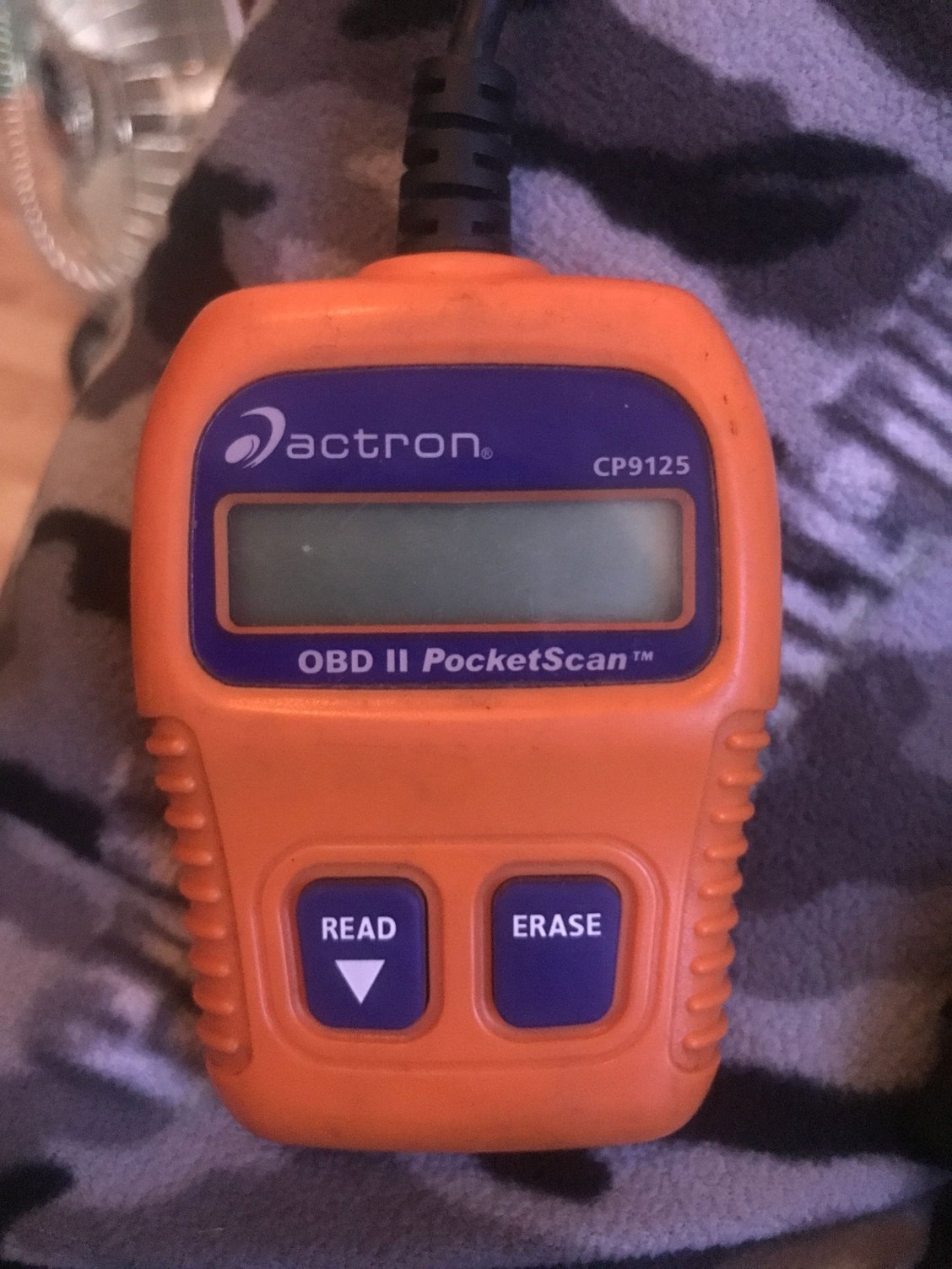

I don’t own a Bluetooth obd scanner… I have a little duralast one. Is it possible to check fuel pressure with a regular obd scanner? How much does a Bluetooth obd scanner cost?
Is this a scanner or a code reader? What is the brand and model number? We could look it up and tell you.
A code reader is a basic tool that can only read and clear codes.
A scanner reads and clears codes, but more importantly, it also displays live data such as fuel pressure, air flow, etc.

This is the scanner I own. Serial# M0216206.
